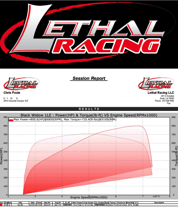

800rwhp - First phase of the build complete!
2014 Camaro 2SS/1LE
6.2L 376c.i. LS3
Manual 6-Speed, 3.91 Rear Differential
100% Built/Tuned/Maintained by Lethal Racing
Powertrain Mods
*Whipple 2.9L Supercharger w/ 3.5" Pulley & Air-To-Water Intercooler @ 13psi Boost
*Lethal Racing Custom Night Fury Camshaft
*LS3 Cylinder Head Upgrade - Manley .700 Dual Valve Springs & Retainers, Comp Cams LSX Rocker Arms & Trunnion Upgrade, ARP Head Studs
*Lethal Racing 5/16th 7.400 Hardened Pushrods
*ARP Camshaft Bolts
*Stock Crankshaft, Connector Rods, Pistons, and Bearings
*Stainless Works 1 7/8" Long Tube Headers
*Catalytic Converters Deleted & NPP Exhaust Deleted
*Ported Throttle Body
*Cold Air Inductions CAI & High Flow Cone Filter
*C5R Timing Chain & GM 3-Bolt Timing Gear
*Melling 10296 Oil Pump
*Lethal Racing Gasket & Seal Package
*ECS Alky Control Single Nozzle Methanol Injection System
* Stock ZL1 Fuel Pump & Siemens 63lb/hr High Flow Fuel Injectors
*MSD Fuel Pump Booster
*NGK Spark Plugs
*Mobil-1 Synthetic 5W30
Engine Dress Up Mods
*Holley Valve Covers - painted GM Victory Red
*OEM 1LE Strut Tower Brace - painted GM Victory Red
*Billet Fluid Caps w/ Carbon Fiber Inlay
*Billet Fuse Box Cover
*Billet ECM Cover
*Billet Oil Fill Cap w/ Filter Breather
*Custom Lethal Racing Decals
Exterior Mods
*MPD1 Z-Force Ram Air Hood
*5% Suntek Window Film
*Custom Supercharged 1LE emblems by EmblemPros
*Custom "Black Widow Edition" Decals by Trinity Graphx
*Carbon Fiber Bow Tie Emblem decal overlays
*Xenon Hyper Blue HID Bulbs - Low Beam Headlights
*Xenon Hyper Yellow HID Bulbs - Fog Lights
*Mickey Thompson ET Street Slick Radials (305/35R20-Rear)
Interior Mods
*Custom Supercharged 1LE emblem by EmblemPros
*Custom "Black Widow Edition" embroidered Leather Seat Head Rests by Trinity Graphx
*Hurst Short Throw Shifter
*ZL1 Aluminum Brake, Clutch, Accelerator Pedals
*93 Octane Pump Gas/Methanol Injection indication LED's
*Lethal Racing Custom ECM Toggle Switch - On The Fly conservative/aggressive ECM Tune Change
100% Lethal Racing Built/Tuned/Maintained

that is one bad bitch. 800rwhp on stock bottom end huh? very nice.

Is all the running gear stock? Axle's, drive shaft, mounts, etc... If so that is great to know our car's can handle that much! Awesome build by the way!

Awesome build, subscribed! I emailed Whipple after hearing about your hood clearance issues and they are going to make available a different heat extractor that should eliminate that issue if anyone is interested.
