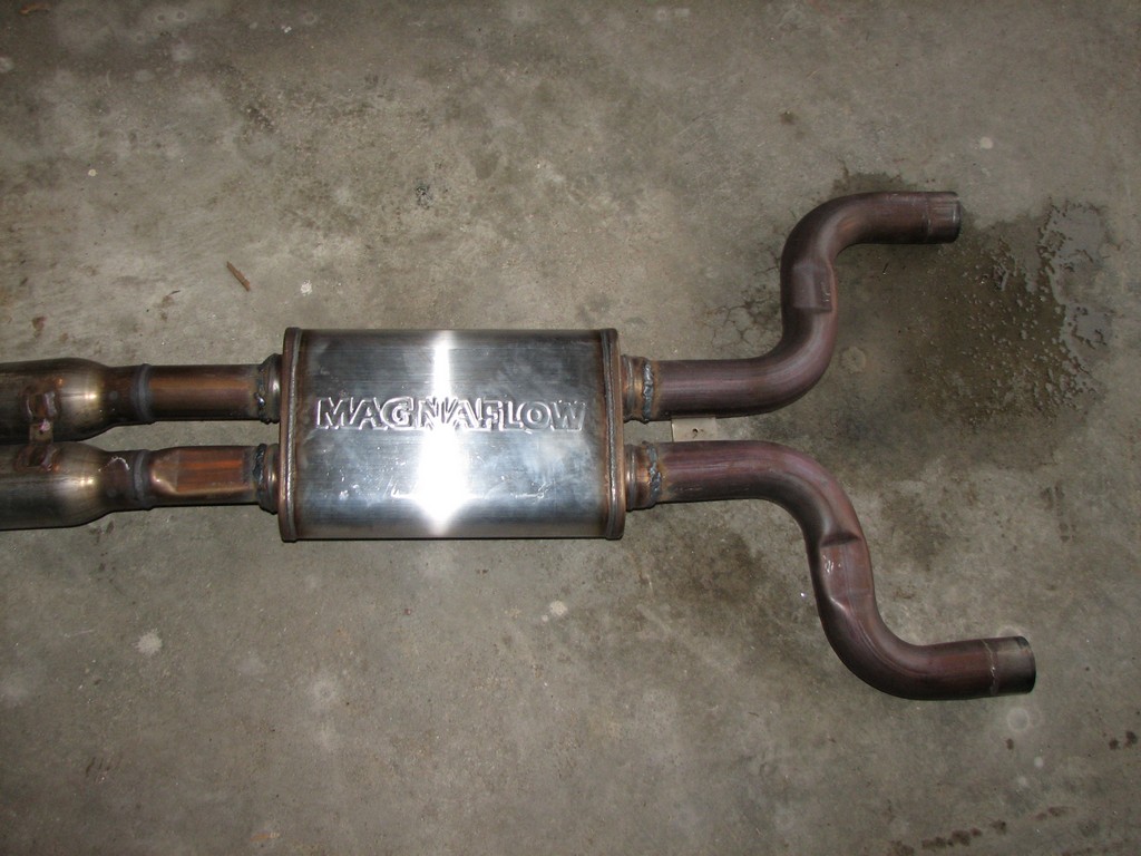

Also, If you plan to install OBX headers with MRT's I HIGHLY recommend getting the Mangaflow Resonated X Pipe (part no. 11386). This will help tone down the bad sounds you will experience at the 2500 to 3500 rpm range.

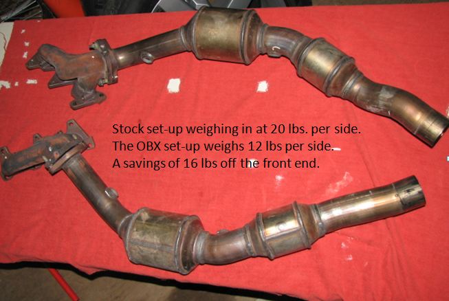

Second for those who wondered about the weight, the OBX headers will save you 8 lbs per side, or 16 lbs off the front end. The Stock set-up weighed in at 20 lbs, the OBX’s weigh only 12 lbs. per side.

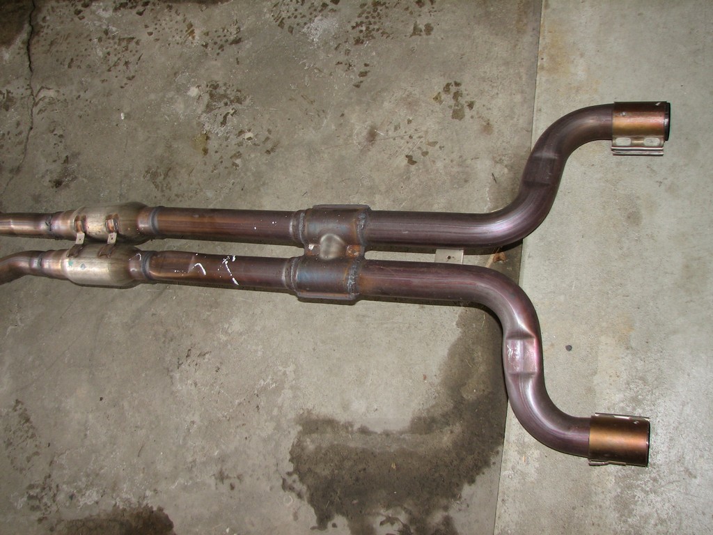

Final wrap up for now. I love the headers. I do not like the rasp and sound at 2500 - 3500 rpm's. There was to much noise and unwanted sound. However, talking with some of our resident experts, (you guys know who you are too, because I send you at least one PM and THANK - YOU for all your help), I have just completed my order for the Magnaflow Resonated X pipe. I have a friend of a friend who will weld this in place. I will know in a couple weeks if this helps me out to the point I think it will.
The X pipe is installed and it sure does make a HUGE difference. Toned down the annoying portion and deepened the overall sound to make my system sound GREAT.
