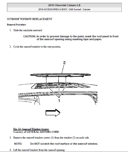

I think the glass comes already framed and bolts to the slider with 4 bolts. No need to remove the headliner. Just get the glass and do it your self.

Don't need to touch the head liner to replace the sun roof glass.

And this is just one reason a lot of dealerships have a bad rep. Trying to hose the customer on a customer pay job, or they don't have a clue how to do the job so they figure they'll just charge way more labor than needed to cover the learning curve.
My body shop did the R&R in 30 minutes when they had to pull it for paint touch up.

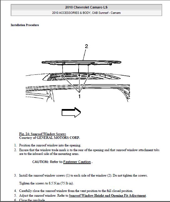

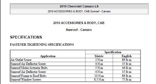

Thanks Guys! Is there a way of knowing when the window screws are torqued to 8.5 N m/75lb in?
Most torque wrenches with a 1/4" drive have lb/in settings.
