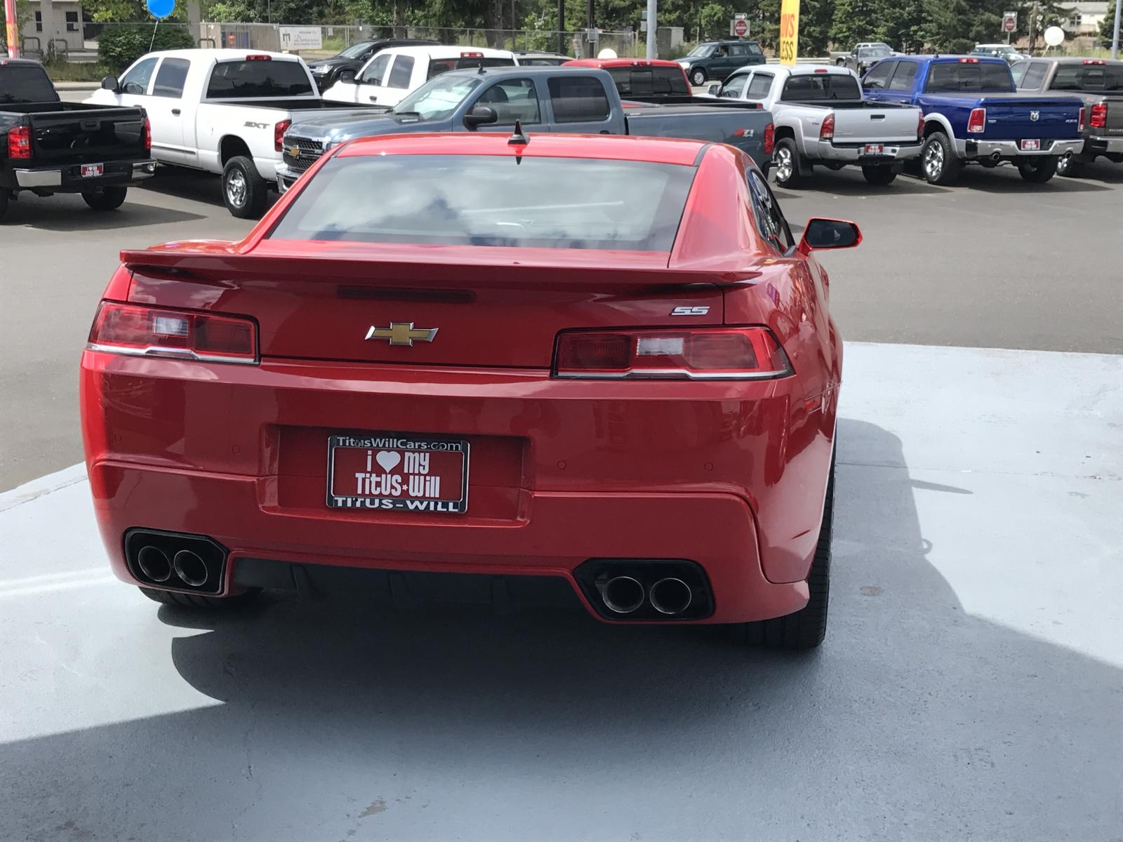

So I'm a really big fan of the RS package tail lights. I think they look way better than the ones on my car right now. It might seem like a dumb question but will they just Fit right on and work with the same connections? I'm trying to figure this out before I spend money on buying them to find out.
I've got pictures of the two. You tell me which one looks better.

No . you will have to get a gen5Diy conversion harness for non rs to rs ..once you get that..its plug n play

Looks like your car might be a spring edition as well ??

Definitely look better IMO. I actually just did this swap in April. Super easy. Just remove the rear bumper all at once and swap the lights out, and yes, need that harness from Gen5

I have the rs light but I like what you’re running. It has more red and less white to ruin the monochrome look. It’s also not as busy looking. That rear splitter looks awesome. Get a red or black bow tie and ss emblem so everything matches. Nice ride.
