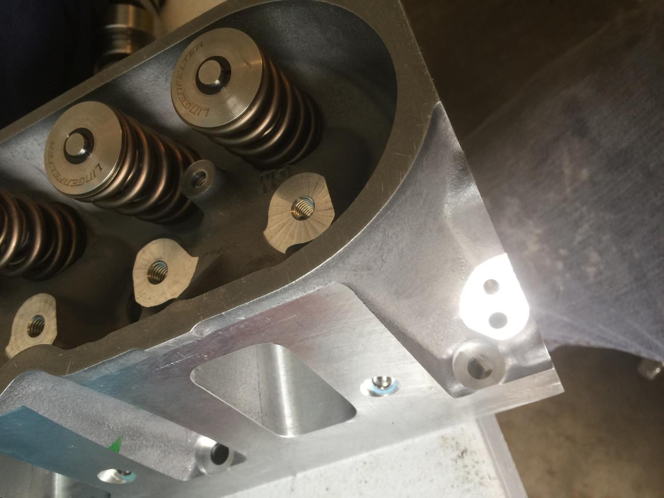

Had a question I swapping out the heads and got the lingenfelter ported heads and noticed on the back of the heads there is a hole like the one in the front for the coolant line was it supposed to come with something for that cause there is nothing .

You need to remove the crossover plugs from your stock heads and bolt them up.

Thanks a lot
I have those on the front of heads I just read that I'm gonna need ls6 Coolant Crossover Block Off Plugs for the back of heads
