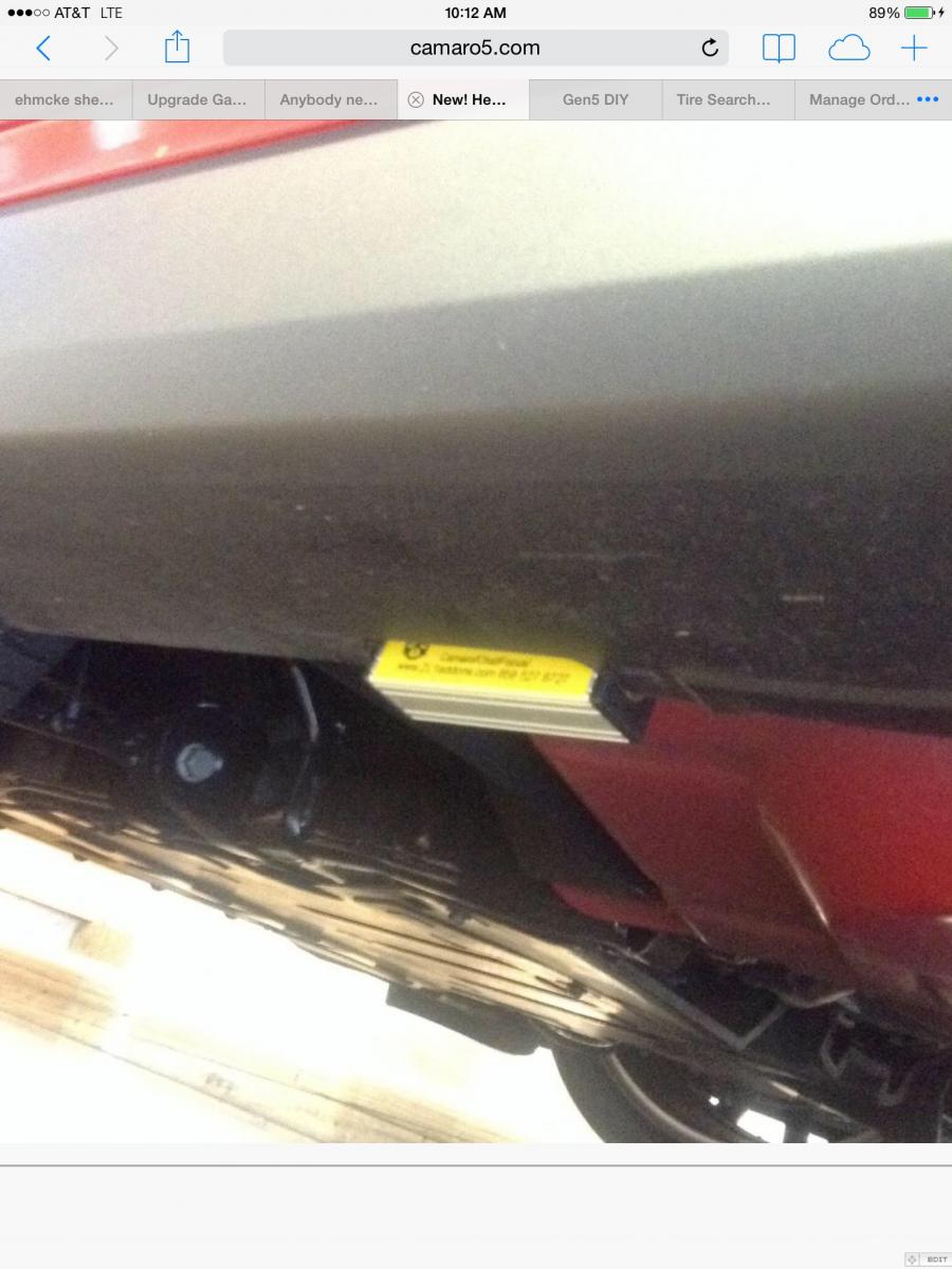

@skylane, I own these ZL1 add on Jack pads. They have split my jack black rubber pad. So I put wood on the Jack and the aluminum block on that and the 2x4 snapped too. Does the hand drawn picture in your link that says 1" wheels off the ground mean that the car should only be raised 1" off the ground?

Im not sure how i feel about these at this point. I bought 2 of the plastic one's and they just didn't work, in fact one of them split right down the middle. At Fontana in May MTCobra gave me one of his metal one's, it actually worked but slipped and bent my metal lip. Sorry the pic's are a little blurry but i had the camera as far away as i could to get the pic, i could of jacked the car up to get a better pic, but im confident all here can see.

I always used a hockey puck in the jack pad with my other cars, I tried the aluminum one top of the puck because I was trying to avoid puckering the skirt, and it turned under just like Cornerspeeds! Now I put it directly on the jack, I wish it was bigger and less prone to rolling over.

+1. My plastic one split in half the first time used and thrashed my rocker and ruined a rock guard when the jack moved and car fell. Threw them out.

I use the metal ones, a lot, and I haven't had any issues. However, I do wish the base was wider because every time it looks like it could shift and roll, just like it has in the pictures. I wish they were made with a wider base, like a trapezoid.
