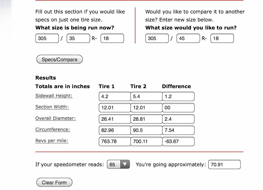

Ok guys, so I have a little issue..... I ordered some mickeys T 305."45".18 but instead got 305."35".18 should I be worry about fitment or issue running this tire? I wanted 305.45.18 since that's what everybody is using on the corvette rims. I might be wrong, but every post I seen that's what people,seem to like.
Anyone else running 305.35 drag radials?

Yea man, that's a problem. 305/35-18's are only a 26.5" tire. If you're running the stock 20's up front your ABS is gonna freak the hell out.
