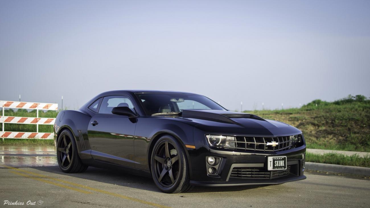

Size:  83.1 KB275/40/20 up front 315/35/30 rears and no problems at all!

Originally Posted by SkunkJunk420 View Post
Attachment 719864275/40/20 up front 315/35/30 rears and no problems at all!
How are you liking those INVO, how is traction with those? Any more shots of that set up?
I had them before PSSs. I auto cross so it is night and day difference. For that or drags Invos suck
