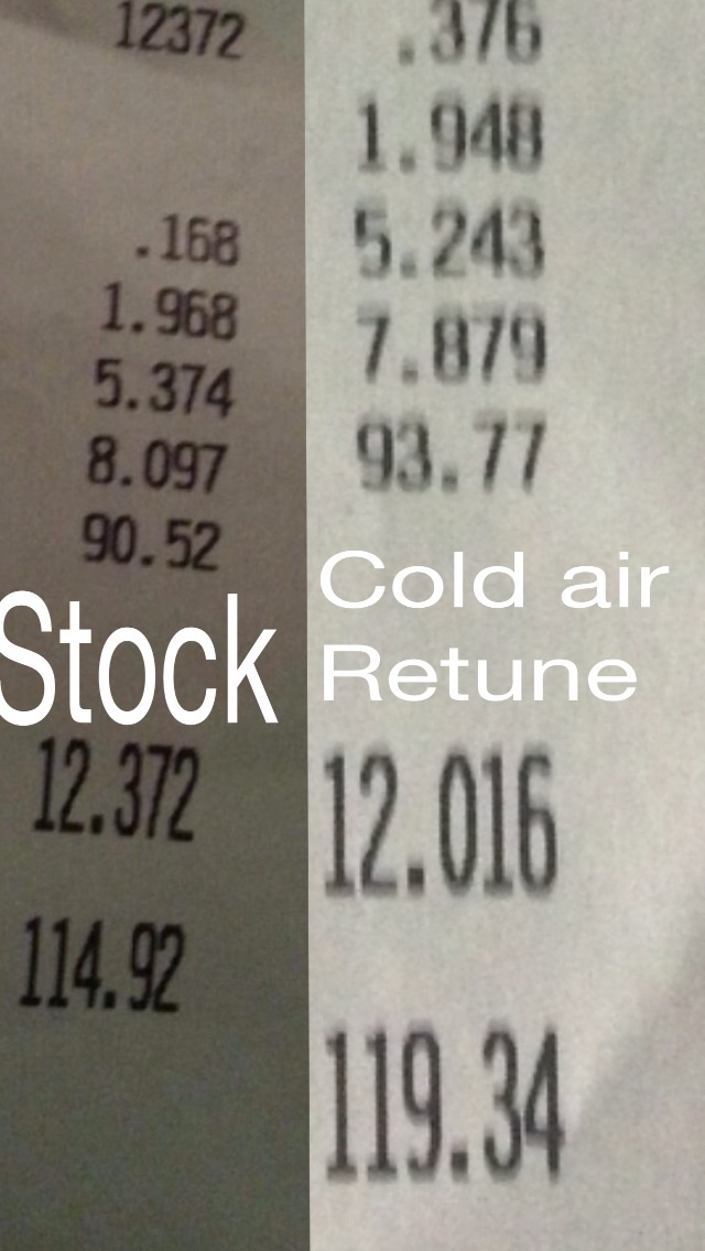

My track times zl1 2014 manual 6 speed stock tires
What do y'all think of my time
80 degree night
25 minute cool down

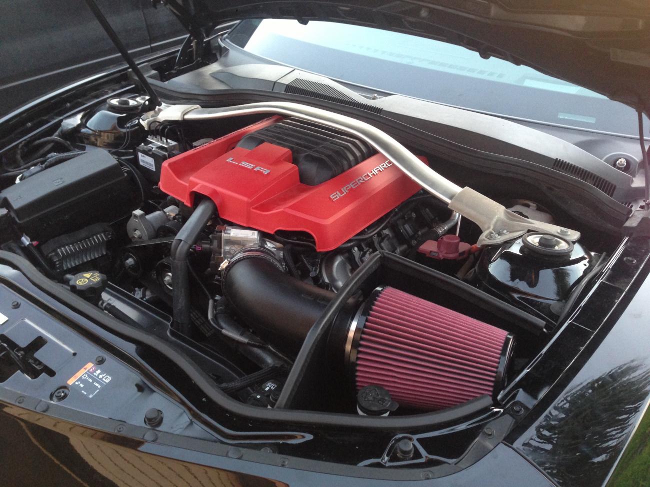

Mods are
Cat delete like I gutted the oem cats
And a jlt cold air
160 degree thermostat
On the 12.0 run the car spun a little off the line and going into 2nd it hopped a little
Wanna hear some opnions
Also I tuned the car myself
Car was tuning about 24 or 25 degrees of timing and a 11.76 afr ratio
Stock run was made after a 2 hour cool down the 12.0 was after a 25 min cool down
First pass correct
2083 ft above sea level
12.266 @ 115.899
Second pass corrected
2222 ft above sea level
11.903 @ 120.437
Tomshaze is offline   Reply With Quote

good MPH on the second one.. I would be curious of the DA between the 2 runs.. I was surprised the difference the last time I went to the track just in a couple hrs made..

Thanks man and a we I wish I knew the slip doesn't say anything about the da guess my track doesn't do that??
I always figure the DA on my own. If you have a smart phone there are a couple apps that you just plug in the weather/ Altitude info and it gives you the DA

If you know the track, date, and times of the passes you can get the DA from here:
http://www.dragtimes.com/da-density-...calculator.php
Without knowing the difference in the DA between the two passes, you can't judge the effectiveness of the mods and tune.
How do you know you were at an 11.76 afr? You are using a wideband I assume?

Ok thanks for te info first pass
Corrected
12.266 @ 115.899
11.903 @ 120.437
Yes I tuned it myself using hp tuners

corrected times are not exactly accurate. Just post the actual e.t/mph and the DA and we can calculate the e.t. Just as a positive DA slows you down, a negative DA speeds you up and I doubt many people have corrected in that direction for an e.t./mph post. Yes, I see your posts of the actual slips but the "corrected" e.t. is not necessary.
