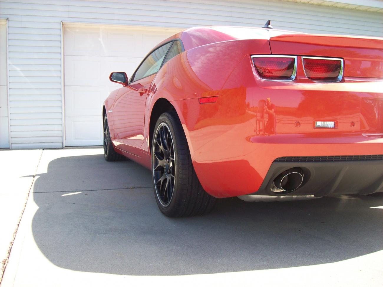

The car in the first set of pictures has front & rear tires using 45 & 50 aspect ratio tires.
I later changed the tires to a 35 aspect ratio side wall, & now need to lower the car at least 1.5 in.
All the best,
Orange 2010 Camaro
