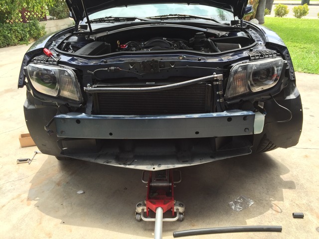

I started my LSA supercharger install on my 2012 Camaro SS. I purchased the kit form ADM, link below. After I did some research on the net on various forums, including this one, I found that the stock heat exchanger is simply not enough. This build was supposed to be a low cost build so I didn't want to purchase a $1k heat exchanger. On another forum, something caught my eye. Someone mentioned that people have installed the heat exchanger off of a 2012+ GT500. I thought this was crazy and interesting, but I could not find any other information on the net concerning this. So I decided to jump on it myself and try it out.
I purchased a used heat exchanger from eBay from eBay for $200. It's a dual pass and is thicker than the stock ZL1 heat exchanger. The outlet and inlet ports don't match up and brackets would have to be made but this is can work.
I'll keep this post up with pictures of my install. I'm not going to add too much stuff from the LSA supercharger install cause there is a really good one here already.

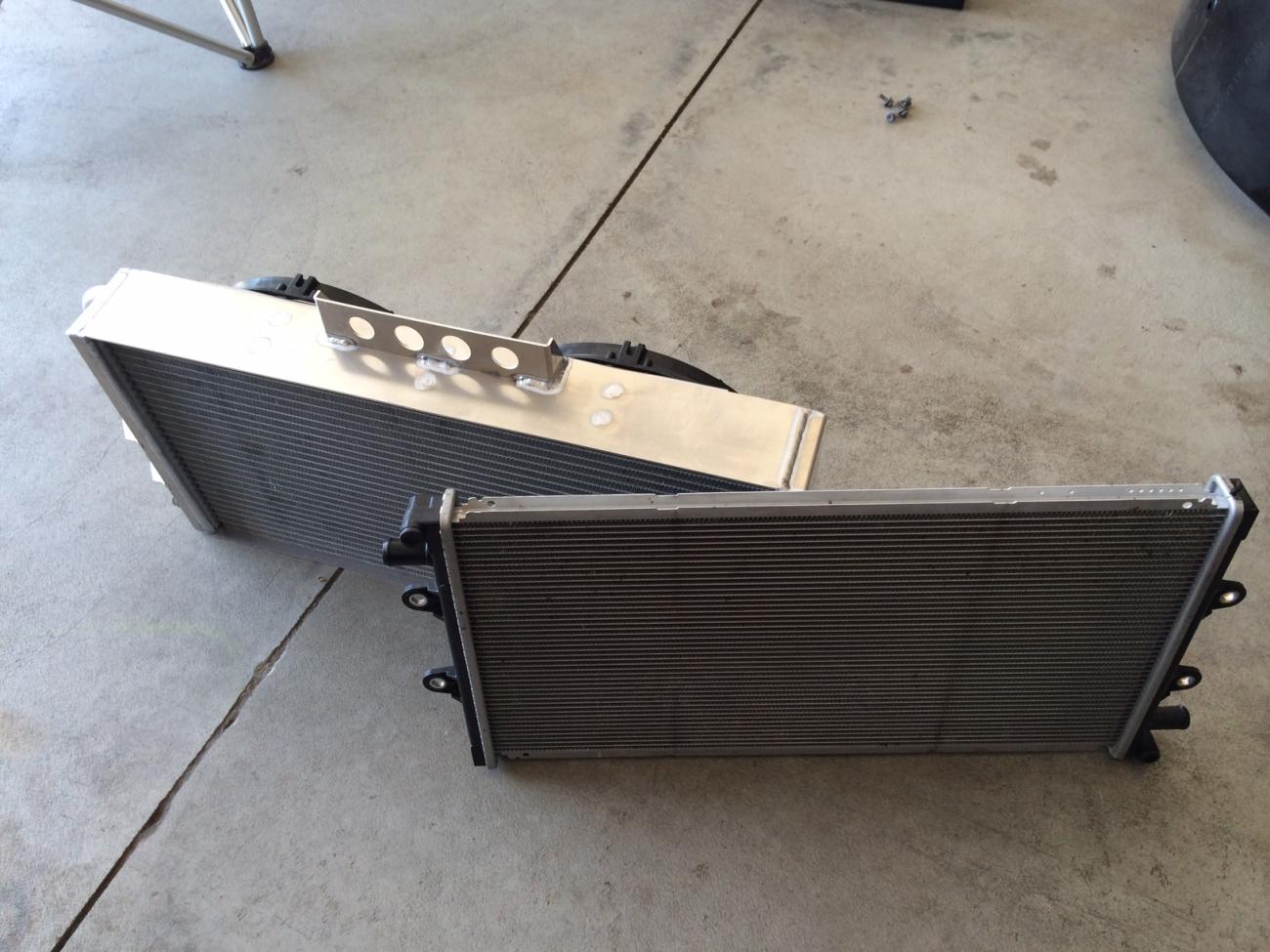

just to illustrate the stock HE size. Here is stock versus the LPE one I just put in

I don't have photos comparing the ZL1 heat exchanger to the GT500 but I do have dimensions.
Stock ZL1: 11x29x1.2
GT500: 11x31x4.5

Here is a pick of the heat exchanger from a 2012+ GT500. Note that there are a few brackets that need to be cut off. Also, the outlet port on the top would need to be cut down or moved. I cut mine down to clear the front grill.

ok. Here is a picture of the heat exchanger installed without the front bumper cover. As you can see, it takes up a lot of space. I had thought about running fans but with a 4.5" width, there was no way I was going to be able to fit fans on it. I had plan to running my lines on the driver side so I had no issues with the way it's routed. This may pose as a problem for a ZL1 but if you had the outlet neck rotated down, i'm sure this could be managed. I did have to remove the trim of the air trey (if thats what is called). Which means I had to relocate the ambient air temp sensor. There is good enough room between the AC condenser and the heat exchanger and the front bumper. The GT500 brackets almost made it to the stock holes on the radiator frame support. It was off by at least 1.5". There was enough length to avoid making a bracket. I did, however, needed to make long spacers for the bolts that attached to the heat exchanger to the radiator support frame. This can be seen on one of the attached images.
Jamob is offline   Reply With Quote
