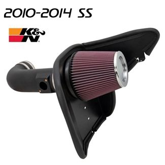

63 series:
Black plastic tube for the intake.

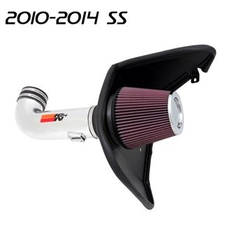

69 series:
Chrome metal tube for the intake.
Both of the above intakes use the same heat shield and filter in their kits. The tube is the only difference.

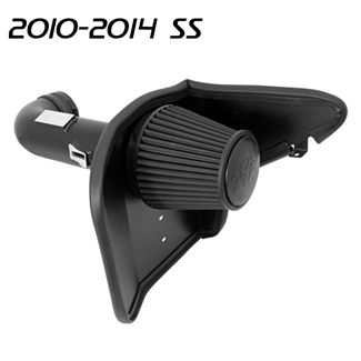

71 series:
It has a metal tube that is powder coated and has a large K&N logo. Uses the same heat shield as the kits above but a different non oiled filter.
Ultimately the difference is in the look and budget. K&N does claim that there are power differences between the kits but those numbers can also vary with car and climate conditions.

The 71 series Blackhawk also uses a dry filter that requires no oil.
