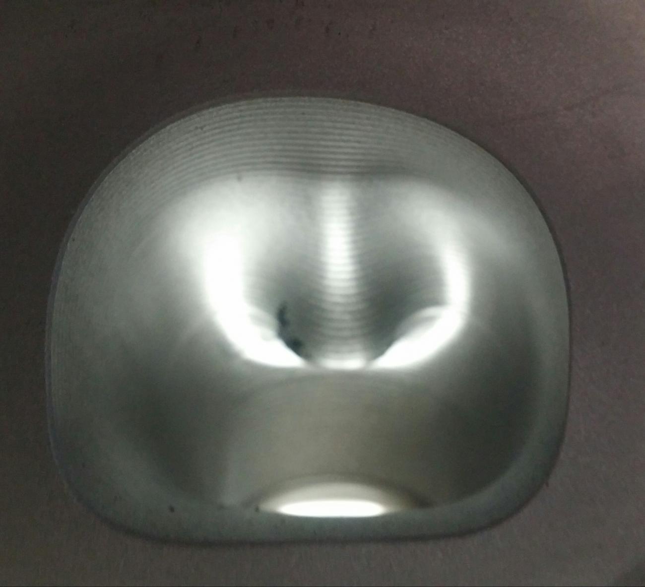

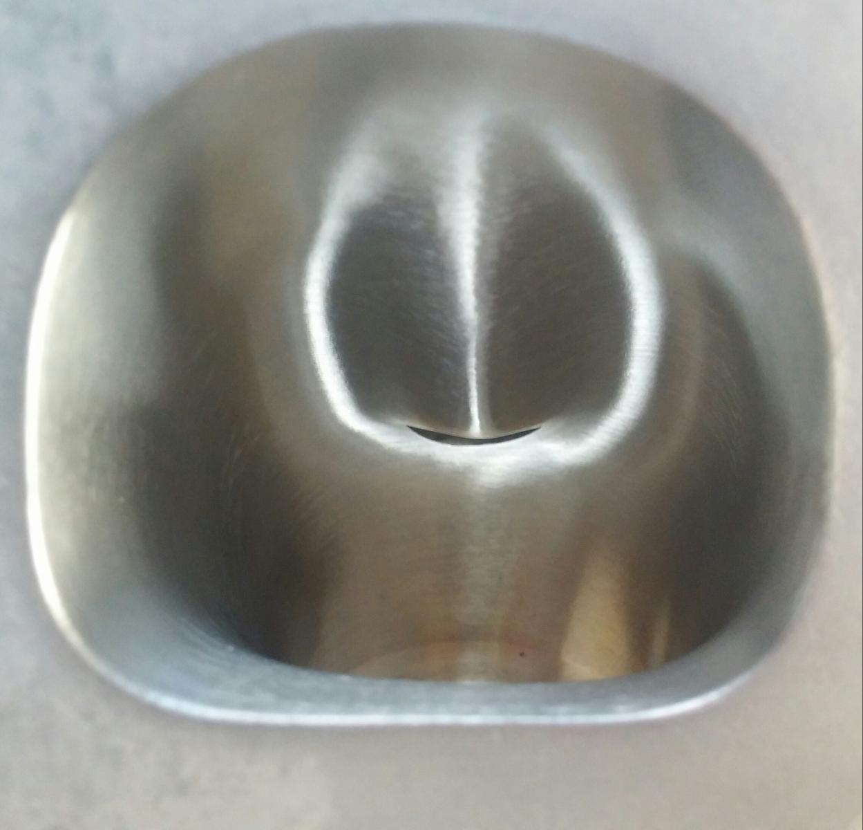

GM cnc exhaust compared to aftermarket
Bo White is offline   Reply With Quote

Very nice Bo , a picture is worth a thousand words.
