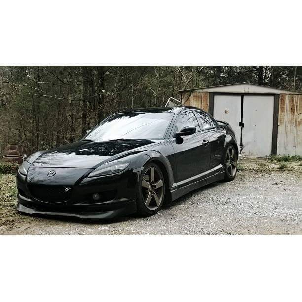

Thanks. My goal is to build the perfect daily driver.
300+whp, 2800lbs, 30+mpg, and a nice handling chasis. I race a 2005 Mazdaspeed Miata and it's not the most forgiving to daily.
Do you happen to know if a 2010-2011 clutch will fit the 2013? If I could get that question answered I'd be well on my way.
Anyway, here's a picture of the RX8 pre-swap.
