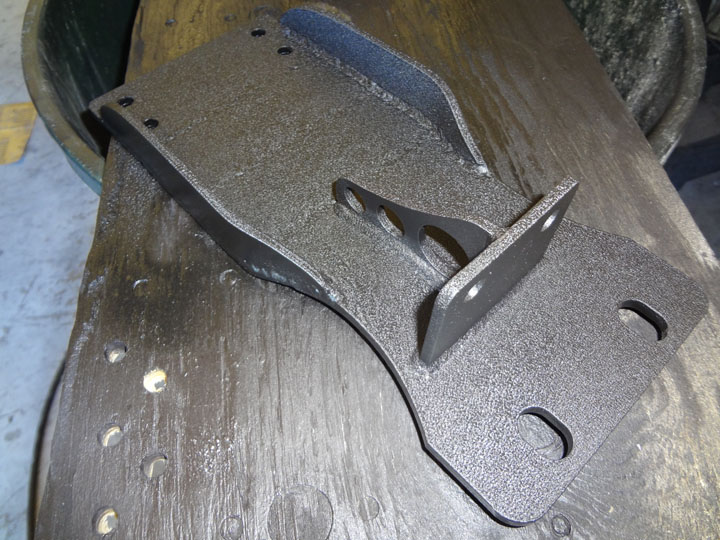

I ended up modifying a DS loop though I don’t remember the manufacturer of the original piece.
This was for dual 3.5 inch exhaust and a 4” one piece aluminum shaft from DSS, modified by Thrash in San Antonio…
As far as mounting a DS loop where the carrier bearing was, I’m thinking that’s too far rearward… I suppose the design would be a factor….
The first image is the original item and this is only an SS, so I’m not sure if the crossmember is the same as that in a ZL1
The next images are the same DS loop as modified by cutting it and then inserting two 2 inch pieces, lengthening it 4 inches and then adding the side gussets.
The last two are as installed.
