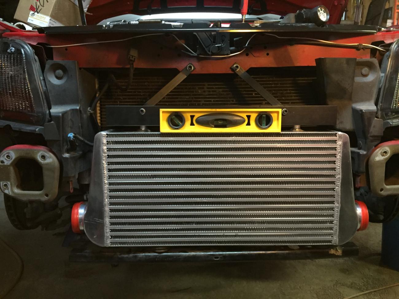

Guys, I will be updating this thread with step-by-step instructions on the INSTALLATION of the Huron Speed T4 kit. I had everything removed off the car prior to this for other projects, so just flip the install for the removal.
I will not be adding text, for the most part, until I have everything wrapped up in the next week or so; meanwhile, I'll post what I have just for visual reference.

More pics! Almost done. Waiting on the turbo and catch can setup to get here and I will begin with some instructions.
