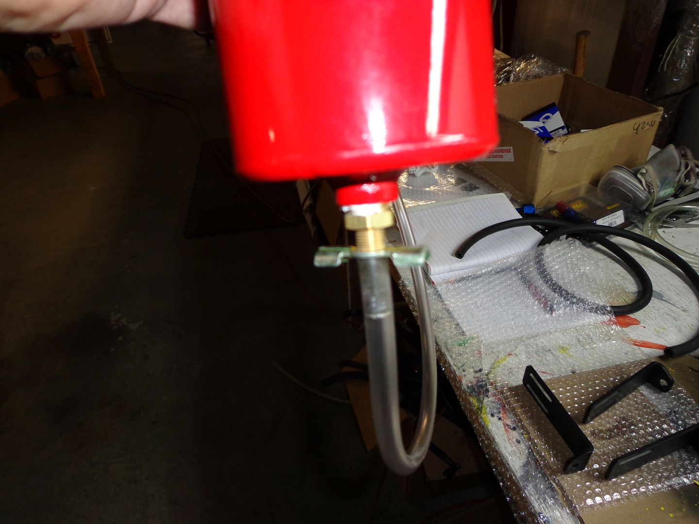

OPEN: (drain position)
CLOSED: (normal position)

I thought the same thing when I first had my RX catch-can, which is the reason I switched away. I don't like the valve on the bottom of the can. I THOUGHT I was opening it all of the way, but I wasn't. Keep on twisting, you might not have opened it enough.
It caught plenty, but I got tired of fighting with that valve and the tube coming from it, and switched over to a can that unscrews.

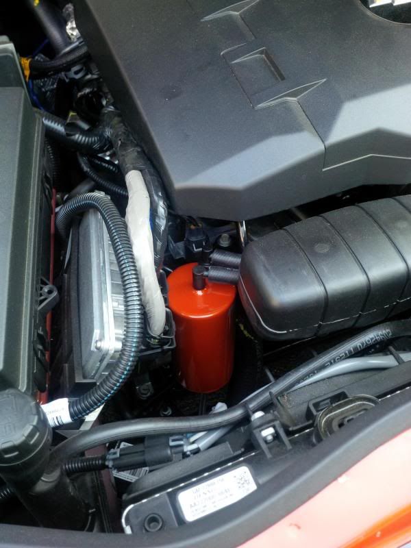

I switched over to an Apex Can back when they were still in business. If I was buying today, I would go Elite.
Old Can:
New Can:
