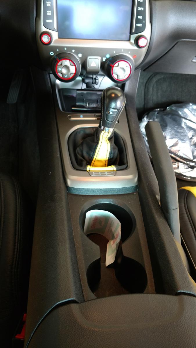

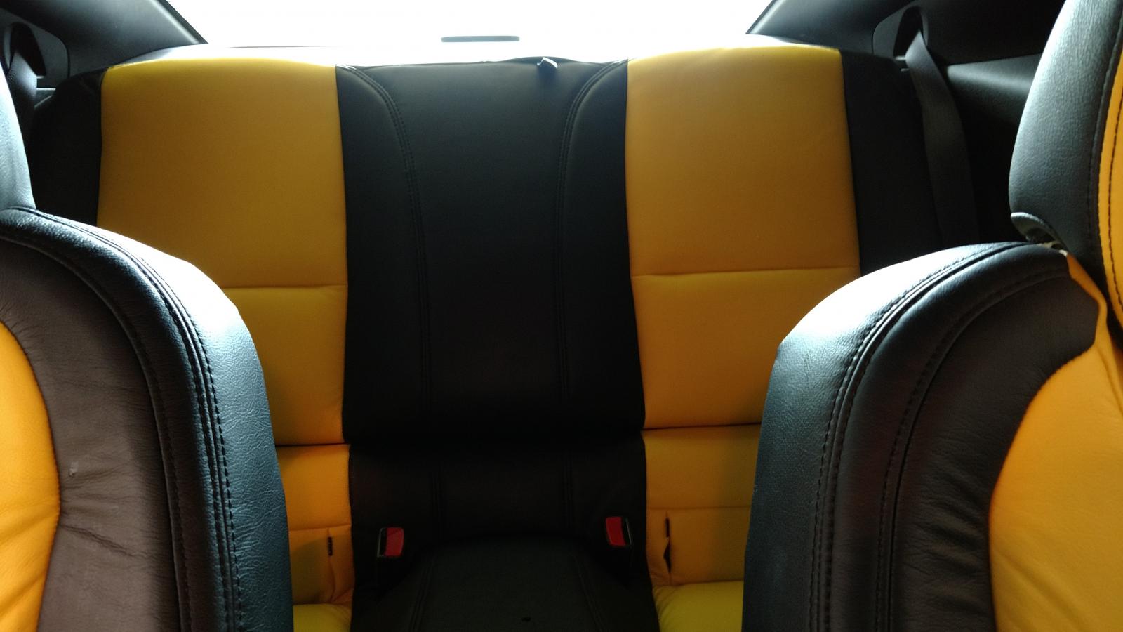

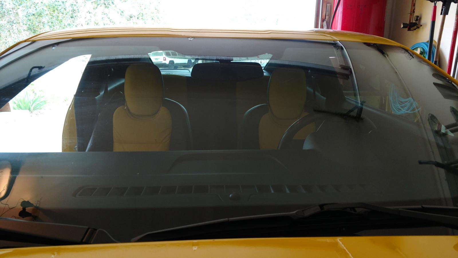

I finally got around to installing the leather seats I ordered, just not in the car. I bout an SS rather than the LS I had. I am happy to report the seats fit great and weren't that hard to install. It took my buddy and I 8 hours to do all three seats which I don't think is too bad for two guys who have zero upholstery background.
Some notes on the kit from Leatherseats.com:
Easiest part rear back rest
Hardest part front back rests
Installing this kit requires 114 hog rings (I bought a kit of 100 and was short that's how I know the exact amount needed)
Kit includes a center console, door armrests, door panels and dash trims.
Kit does not include the shift boot that was an extra $75
