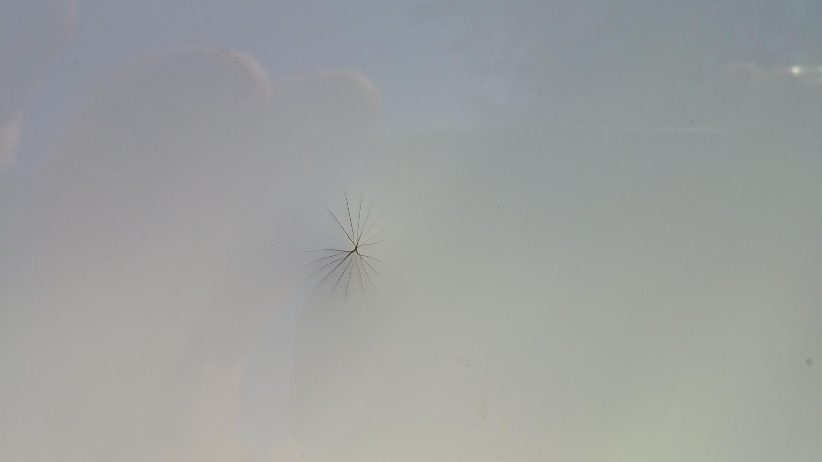

Here are some pics, not the best... forgot to mention that no, the cap is not cracked... that thing is hard though and the hood is thin aluminum...
Your car must be very fast! You were haulin' ass when I passed you!

I wouldn't imagine it would be the cap, I have large strut covers and the hood does not hit them even when driving over bumps.
JerTM is offline   Reply With Quote

Do you have an underhood pic to show us?
