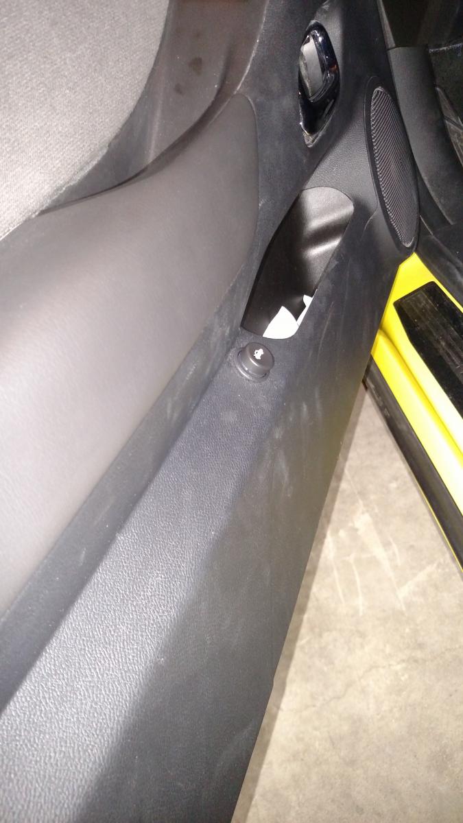

I have a 2015 ss. So I was in a minor fender bender a few weeks ago. Picked up my car and noticed the trunk button did not work. At the same time I was told that the bracket that holds the SS emblem on the front grill did not get ordered but they will order it next day. A week has gone by, I dropped off my car Thursday, 10 Aug. My wife calls today and was told "Well the button works but the bracket never got ordered again, what do you want to do". So I pick it up, I get in the car and say, what the ***k is this. I go back inside and tell the clerk. And they guy who is managing my car repairs is gone so she texted him to call me asap. This is not normal and if I pull in the button, it practically comes out. It's just frustrating but I am definitely holding them accountable. Whats is crazy is my driver's front bumper was where the damage was.

Cut them some slack, lol. I took my Camaro door panel off and the same thing happened to my trunk button when I was removing the wire harness clip. I'm not a rookie and have worked on door panels of many cars of the years.
The trunk button bezel and trunk button have tiny fragile little engagement ears that all must be precisely aligned and oriented just so or it all pops out of place or up like what is shown in your picture. It took me 3 tries and several episodes of experimenting until I finally made the button and bezel behave. At one point it was even recessed too far in to the door. Worked on it doing tweaks on and off for a week, until it was perfect again.
And the front SS Emblem with mounting bracket in the grill is an amazing feat to take apart and get all back together and installed. Those assembly line workers must have the patience of a Saint. The worst part is separating the two parts of the SS bracket when removing.

The trunk switch is actually two pieces, the bezel and then the actual switch. Once the bezel is in place you the install the switch, you have to play with a bit because it will only lock into place one way! Some months back I was building headlight switch modifications for the 94-96 Impalas, part of this modification was relocating the impala's trunk switch. Not wanting a bright yellow switch showing on the dash I opted for the new Camaro trunk switch.
I believe I purchased about 150 of them from Chevrolet and still have ONE switch and bezel remaining. If you or anyone else needs these two parts I will let it go for $20.00 shipped to you. Both are still in the GM package.
I am thinking yours only popped out of its secured position, turn it slowly while pushing down gently it may pop right back into place.
