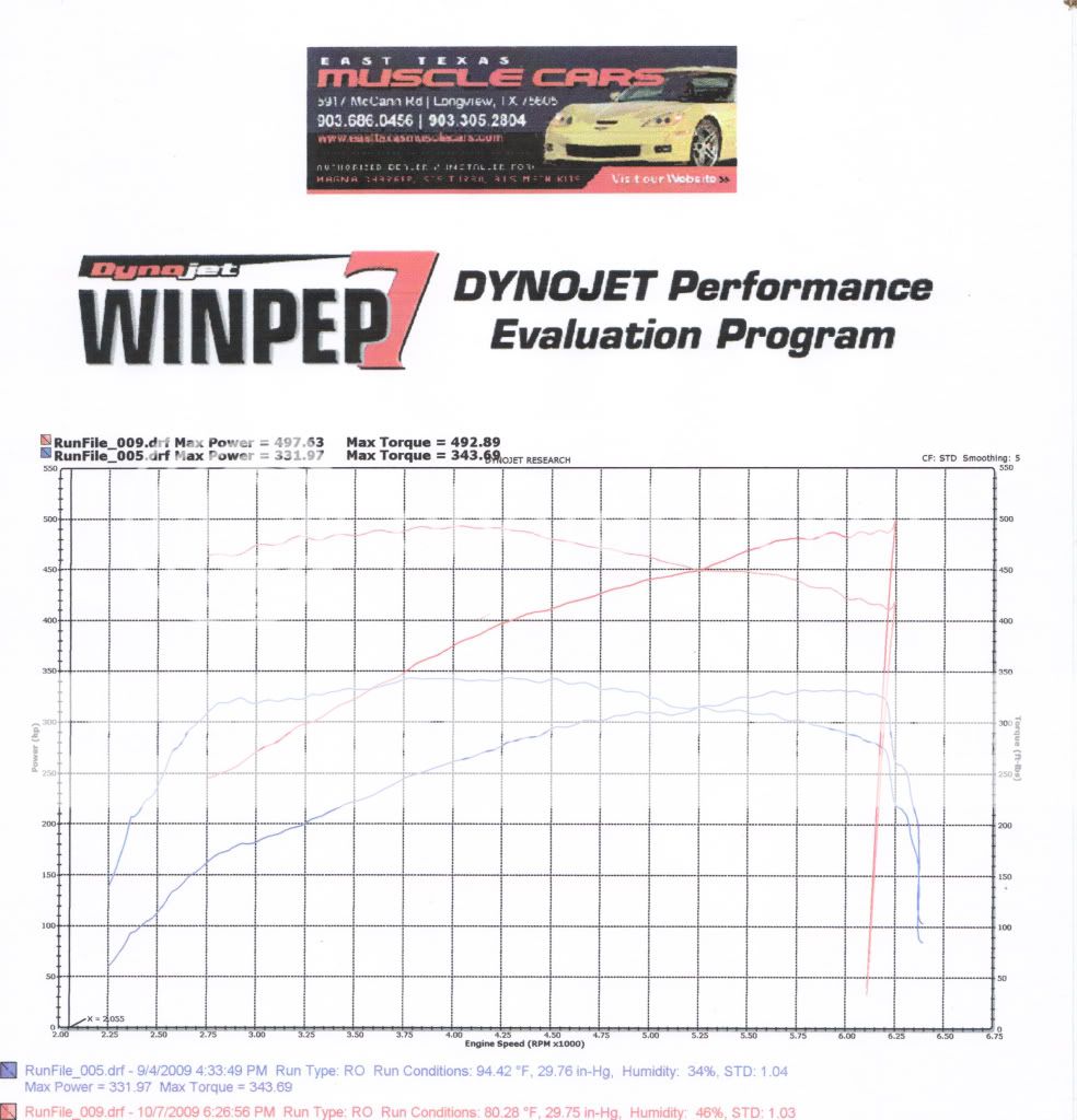

We are the ones that did the work. i have tons of pics and a few vids soon to come on this car. it came in just a HAIR under 500 RWHP through the auto l99 setup. we did ARH headers also with cats and a magnaflow exhaust.

the car did 333 before and cam in at 497 after on around 7 psi through the AUTO converter NOT locked

I put the ARH long tube headers with magna flow exhaust. The engine loves it and it sounds bad A. I have a L99 it dynoed at 333 with the exhaust. We added the 2300 polished supercharger with 7 lbs of boost. Gained 166 HP at rear wheels, not too shabby. Floored it at 40 MPH, wow hold on cause it will light up the tires. Going to put 305 rear tires next week.

No he didnt not have a tune, we didnt tune it till we did the magnacharger. ill get you the #'s and dyno graphs

here is the stock pull over the 2300 pull. afer this pull we did have 4 pull over 500 TQ but HP was lower. best TQ # was 512 TQ

no the pull ABOVE was STOCK bone stock
