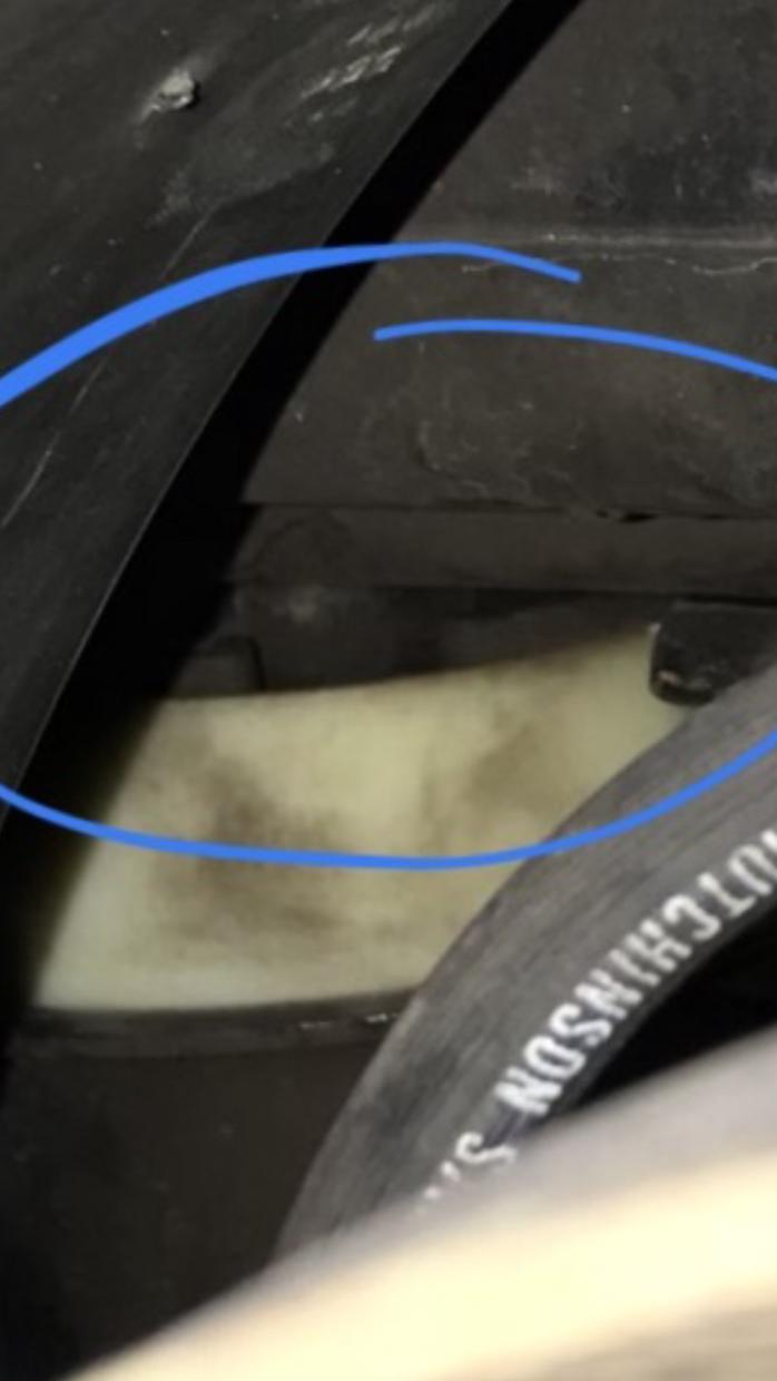

Needed: Pictures of YOUR rear cradle mounts/bushings!
I need some picture(s) of people’s rear cradle bushings/ rear cradle mounts. We put the ZL1 cradle into my car (from a donor vehicle that was wrecked- passenger LCA was tweaked very badly previously, we noticed this once driving my car after the install- all fixed now.)
But I’m really hoping the cradle itself isn’t tweaked any, because my cradle bushings are pretty f***ing tightened, yet the rubber contact patch on the bushing is not touching the car on any of the 4 mounting points.
But I really just have a gut feeling that it isn’t how it’s supposed to be. And while it’s like this I’m afraid to really get on the accelerator or push this fancy new Z rearend to see the limits. I’m not trying to have it literally drive out from underneath me.
But yeah if anyone has any pictures of how it should be I would appreciate it! Also give me some feedback!

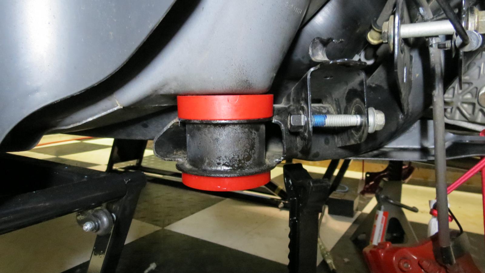

This is normal. I don't have pictures of mine (could take them but can't seem to get them off my phone ), but I do have them on a shelf as I upgraded to solid bushings, and the white rubber does not come all of the way up, flush with the metal - i.e. the rubber does not contact the subframe.

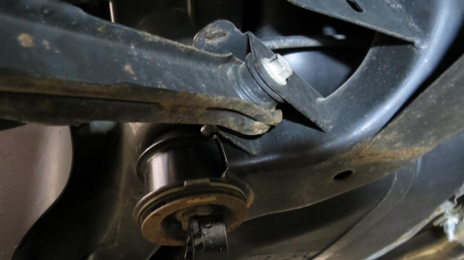

Old and New

Oh okay, Thanks guys. I've been waiting to get my alignment until I knew that was squared away.
