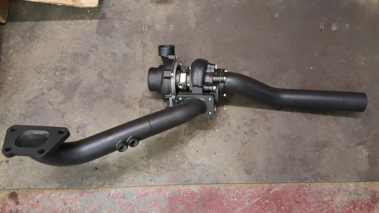

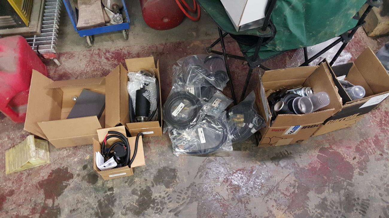

So I just got my twin turbo kit in from Fabberge 2 days ago and I will be starting the install process tomorrow morning. I figured I would go ahead and start the build log for it. To start with, I'm driving a 2012 LS so it's the M6, I could be wrong but I believe I'm the first M6 with this kit to create a thread about it here. If I am wrong please inform me and share a link, I would like to check it out since all I've found is Automatic builds. Anyways, here is a list of my current mods for the car.
Added factory Halo Headlights with the Gen5DIY harness
Added factory Fog Lights with custom harness
20x9 ZL1 replica rims with 275/40R20
ZL1 brake calipers and rotors, powder coated the calipers to match the car
Running Castrol SRF Dot 4 racing brake fluid
Goodridge braided brake lines
Spec stage 4+ clutch with spec aluminum flywheel
Corsa cat back exhaust
SLP 25% under-drive pully
Vmax ported throttle body
Factory strut tower bar
ZL1 spoiler
Barton short throw shifter
Separate clutch reservoir
Kenwood DNX 6190HD
Scosche dash kit
Two MTX 12" subs
500 Watt amp (forgot who makes it and too lazy to go check right now)
I believe that is everything. I will try and add pictures from all the work done to it up to this point before I start uploading pictures from the twin turbo kit. As for the twin turbo kit though, it's the basic Fabberge kit for my car. I'm also using the Innovate SCG-1 Boost Controller for my car since it's also a Wideband Controller too. I will be taking the car to Fabberge in Ohio to have it Dyno Tuned from them. I will post dyno sheets as soon as possible. I'm hoping to have the kit installed and the car back within the next week.
