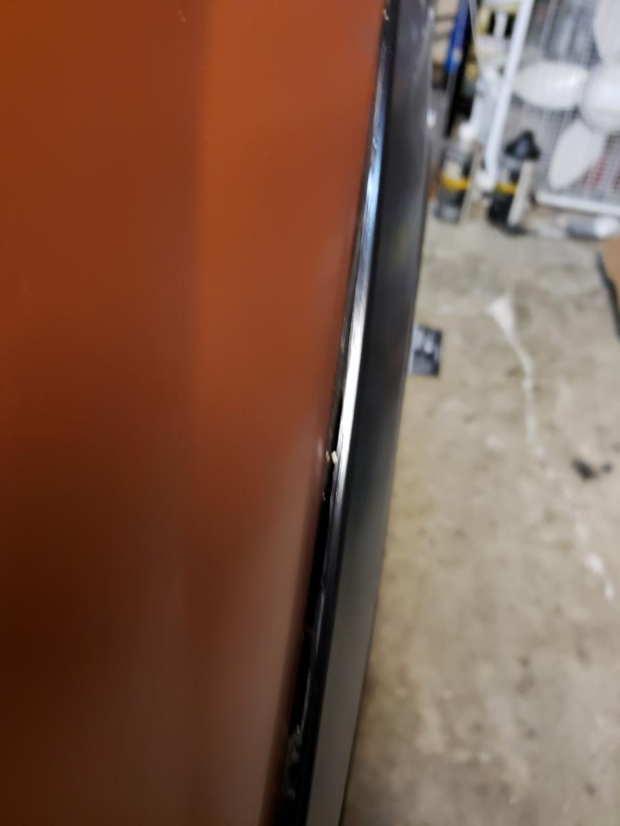

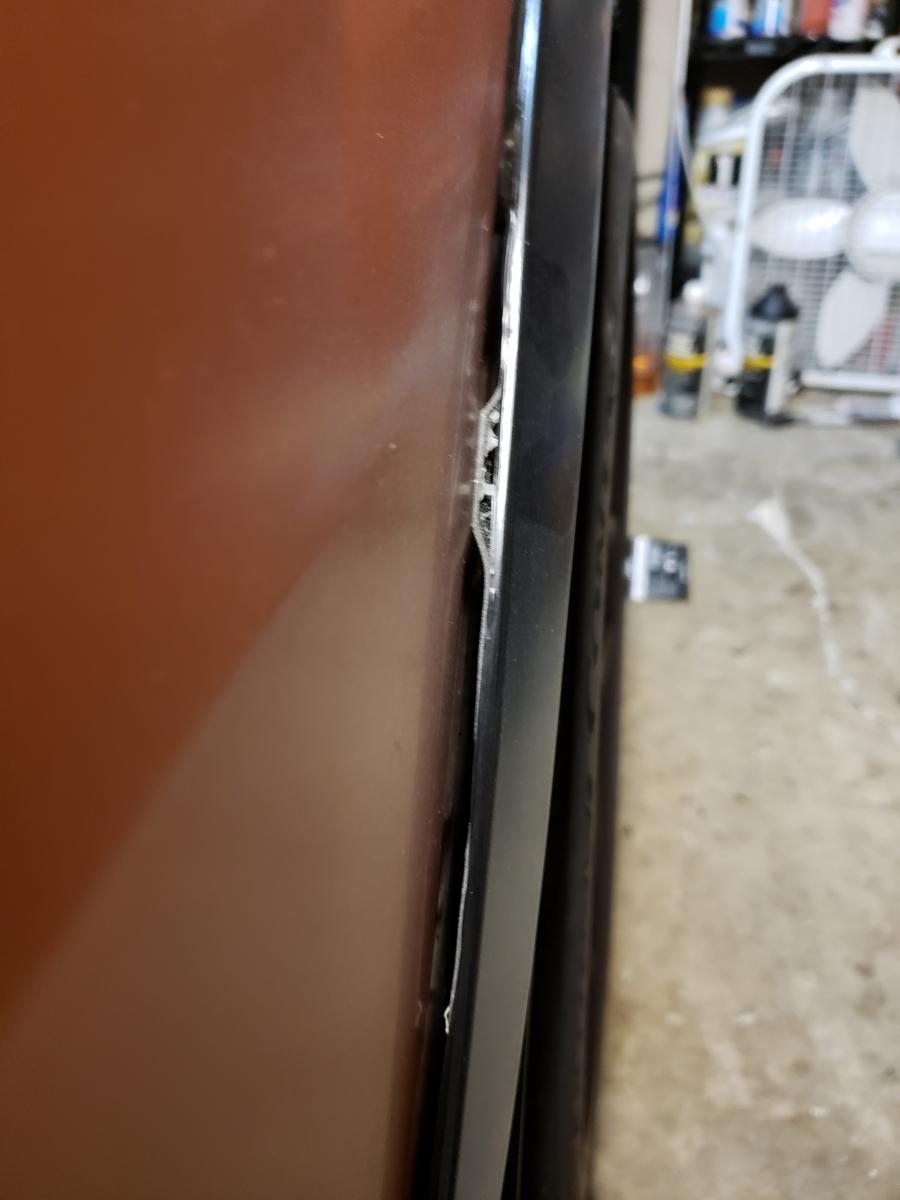

Starting a new thread regarding the flares because the previous one was quite a while ago and I have some new material to discuss.
Common knowledge for most Z/28 owners is that the adhesive used from factory is... lackluster at best. Prior to getting the wrap done, both front fender flares were coming loose. At first I thought it was due to the car's paint being "redone" (I say that very, very loosely).. but research has shown that this is not an isolated incident and my problem is not uncommon. My wrap shop used a combination of VHB and RTV to put them back on when everything was reassembled, and while the rear flares seem solidly on, the fronts are worse than before... I attribute this to a combination of heat, spirited driving (track day) and a bonding surface that isn't the greatest.
So, that leads me to this thread. I'm taking it in today to get my D/S fender replaced and re-wrapped thanks to shrapnel from a concrete pump truck's secondary driveshaft exploding on the highway... and we're going to address the flares. I want a solution that doesn't bond the flares "permanently" to the fenders, thus requiring damaging the wrap/paint if they have to come off. I also want them to be forced to sit flush so that they actually function properly while tracking the car. I know I could use Betalink K2, but I work constantly on this car, and having something on it I can't take off myself is a huge red flag to me.
What we've come up with are several options and none of them make me overly happy. They aren't thick enough near the top of the flare to apply adequate pressure via rivets or screws with compression nuts... and I am not changing to another style of flare so that option is off the table. What we may be going with is a reverse of the compression nuts.. permanently bonding the nuts to the flare, and counter drilling the fender while using bolts/washers etc. to pull the flare to the fender and using a soft neoprene or thin rubber gasket to create an air seal.
Reason for ALL of this, besides the fact I want something that functions and looks like it should, is because I really, REALLY don't want to have to spend $230+ to replace a plastic flare that might come loose while I'm on the highway or track.
Thoughts?

Posts: 590

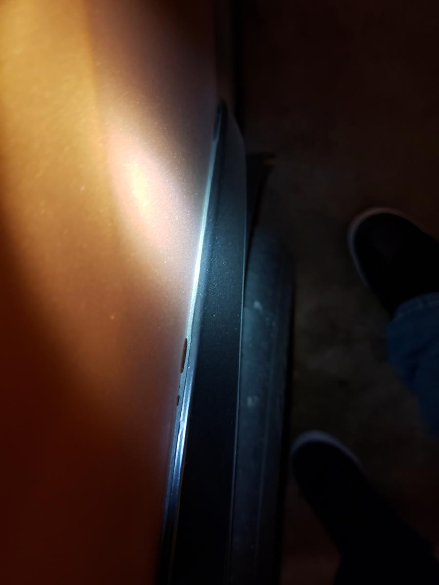

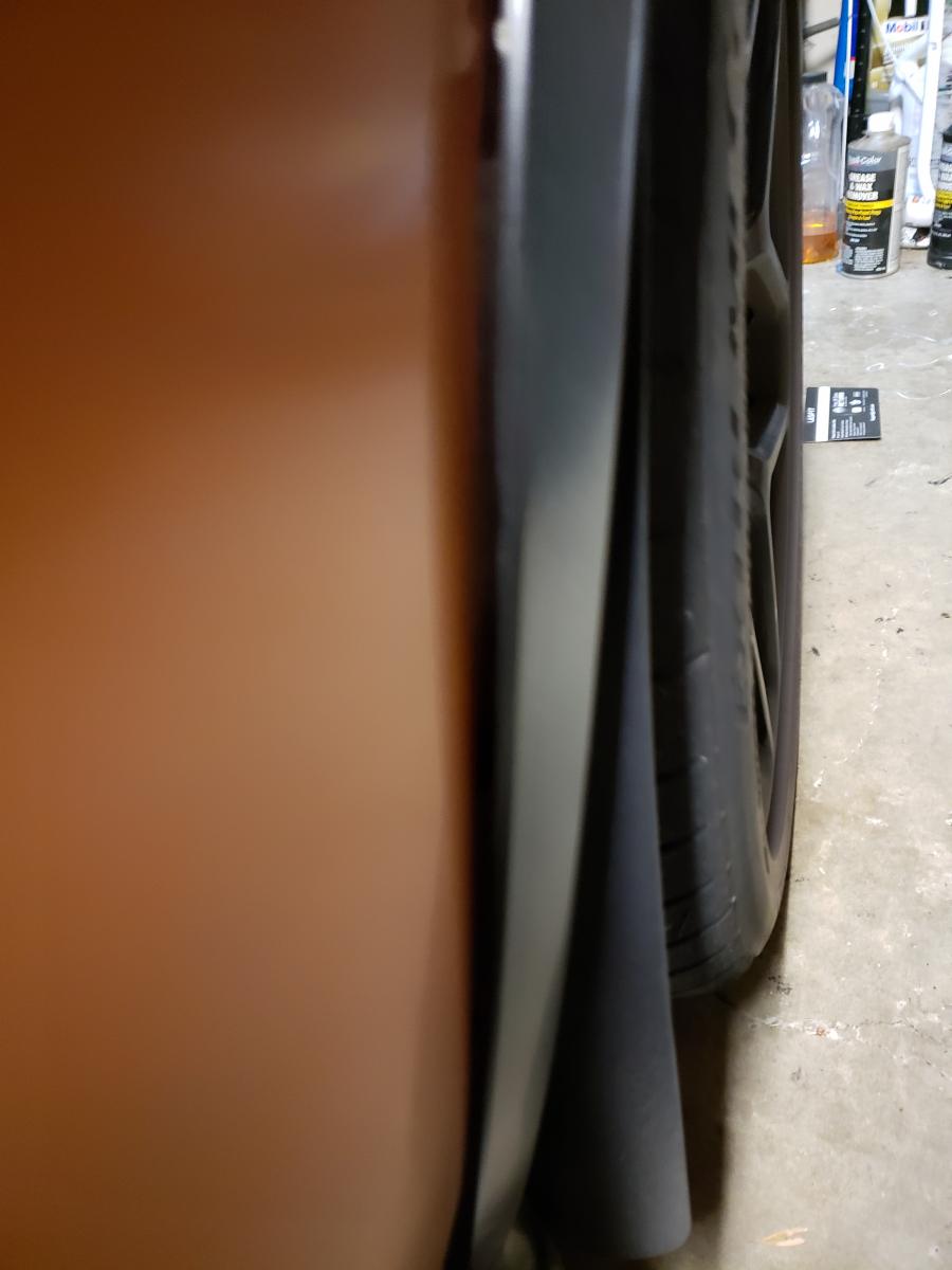

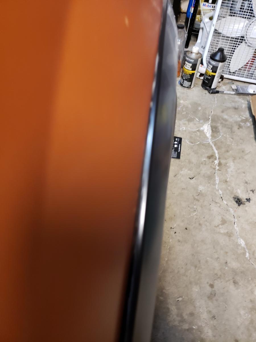

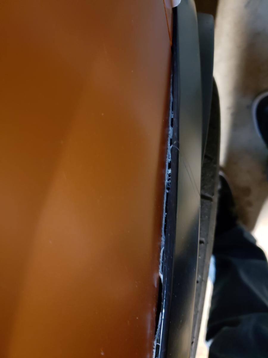

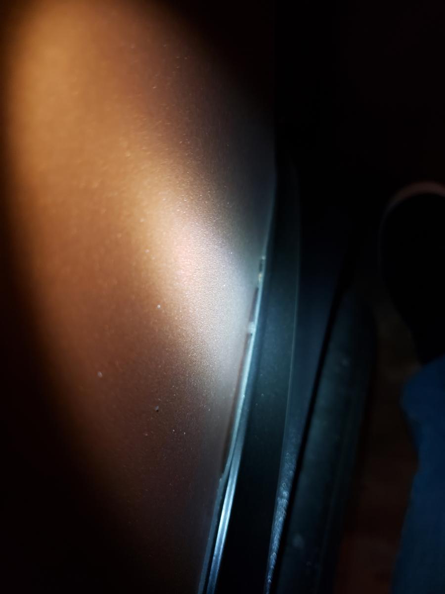

Pics for context.

Posts: 590
Keeping in mind, the fronts were installed the exact same as the rears.. with the same amount of cure time with pressure on the VHB and they are not separating at all.

Posts: 590
No, they were coming off before I had it wrapped. This car has never been bottomed out on anything as far as I can tell.
I'm almost certain it's heat related. It gets pretty hot here during the summer, and I've got 51k miles on it with 8k of that done by me.

Posts: 590
Yeah, your thread was the one I was looking at quite a bit through the whole process. I did have them wrap mine, but the surface between the flare and fender was left as-is (except on the fender itself). Separation is pretty bad, as you can see. And that's with 3M VHB tape.
Having to remove the front bumper to do anything behind it is largely what I was thinking for the future.. which is why I want to be able to take them off without damaging the wrap, flare, or fender AND not have a monstrous hassle. Not to mention stability when I track the car since I plan on taking it to the track more and more in the coming years.
