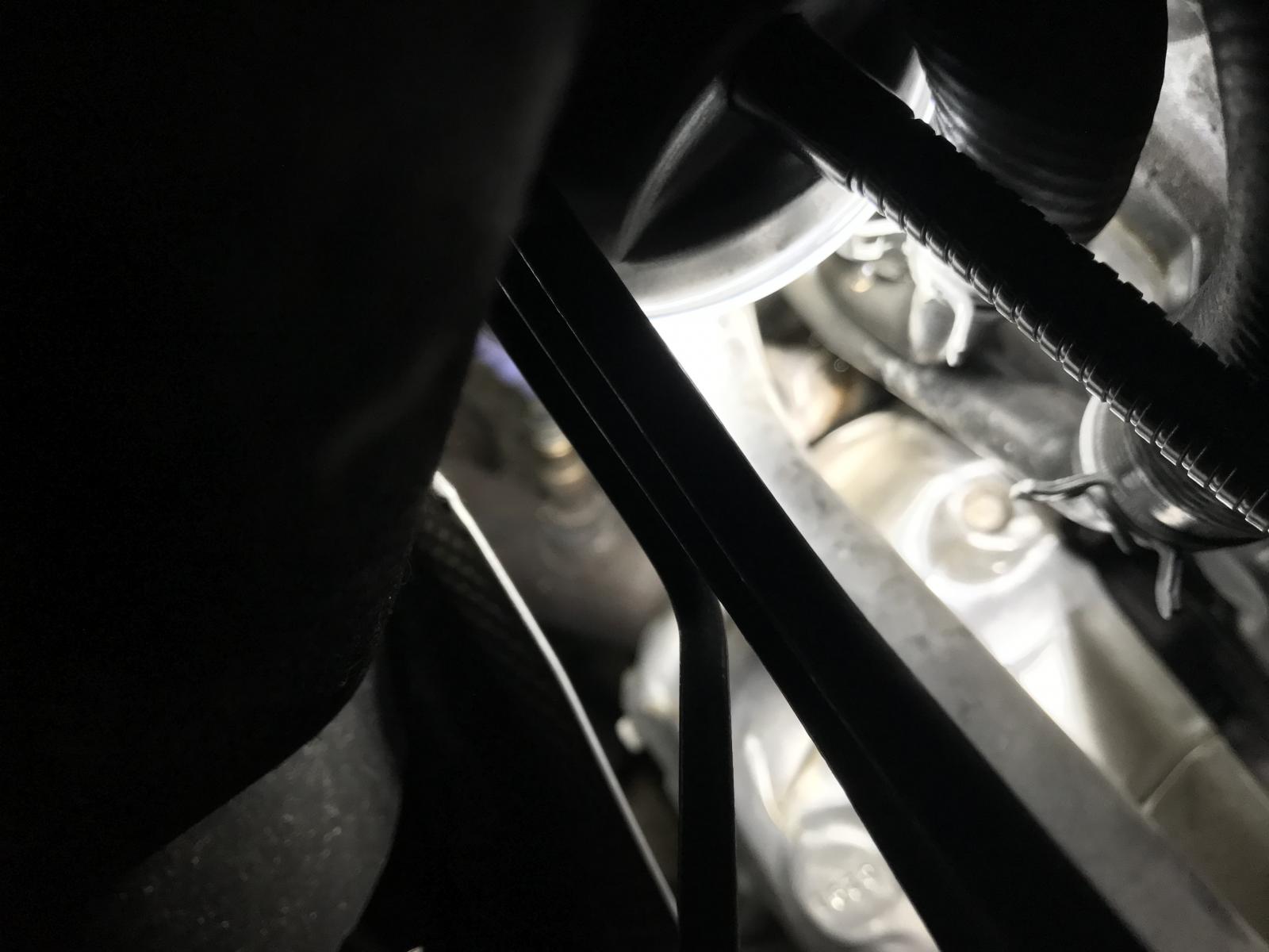

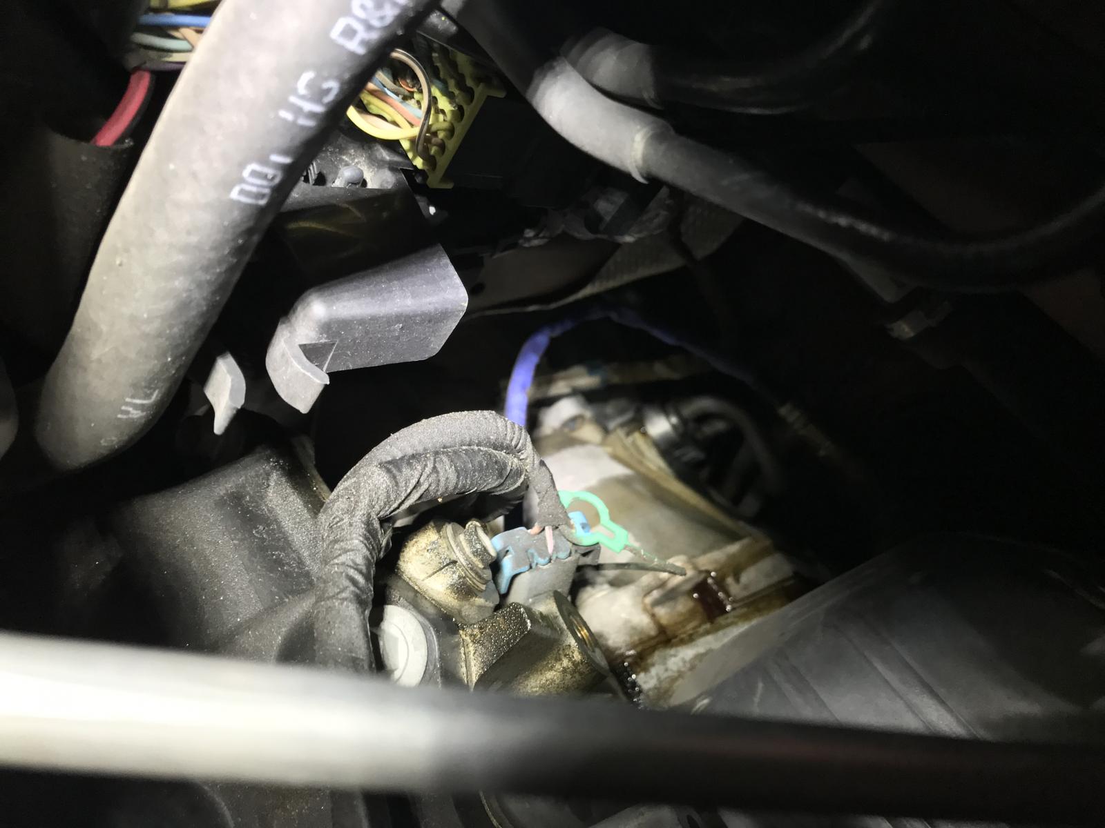

Coolant leak
1st pic is driver side
2nd pic is passenger side
I've got coolant on the back of my engine and was wondering if y'all have an idea about were it may be coming from.
I'm thinking thermostat housing.

The only thing behind the motor is the tstat housing. You have the lower rad hose and the heater hose connections. the Upper rad hose has a o-ring anf heater hose has a gasket not know to leak but is a distinct possibility. hard to see here though. best to get a pic from the rear center right under the vehicle to get a clear idea. still its hard to see. may have to run you hands up there to feel each connection. (cold - )
What I did was run a video from under the car to see whats leaking. My heater hose connection was leaking at one time.
