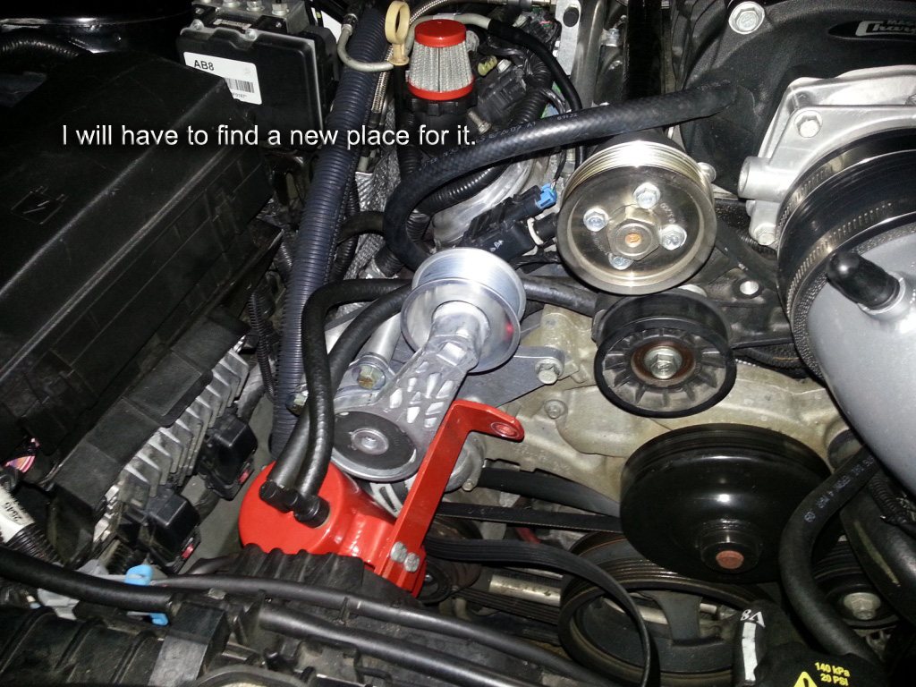

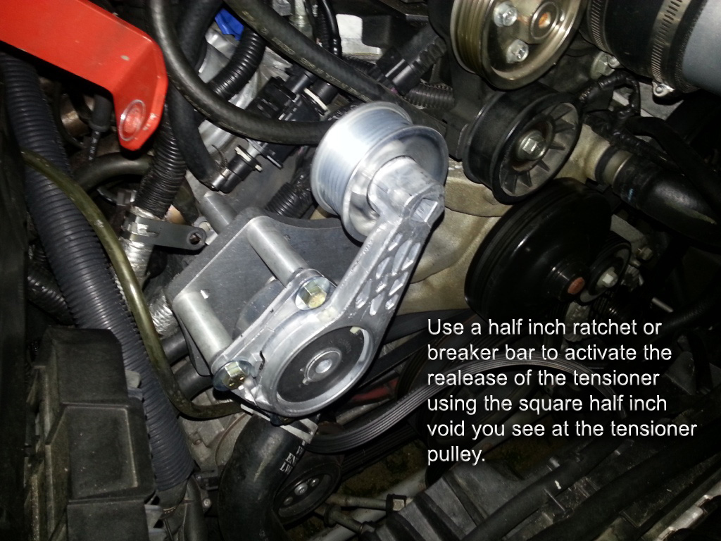

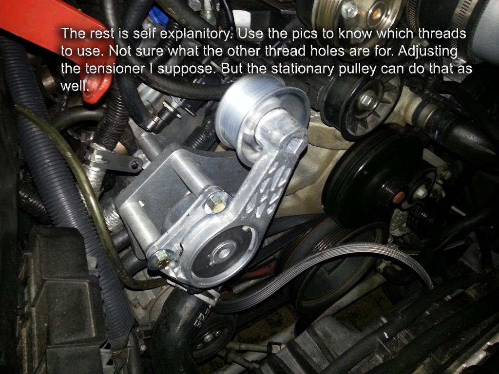

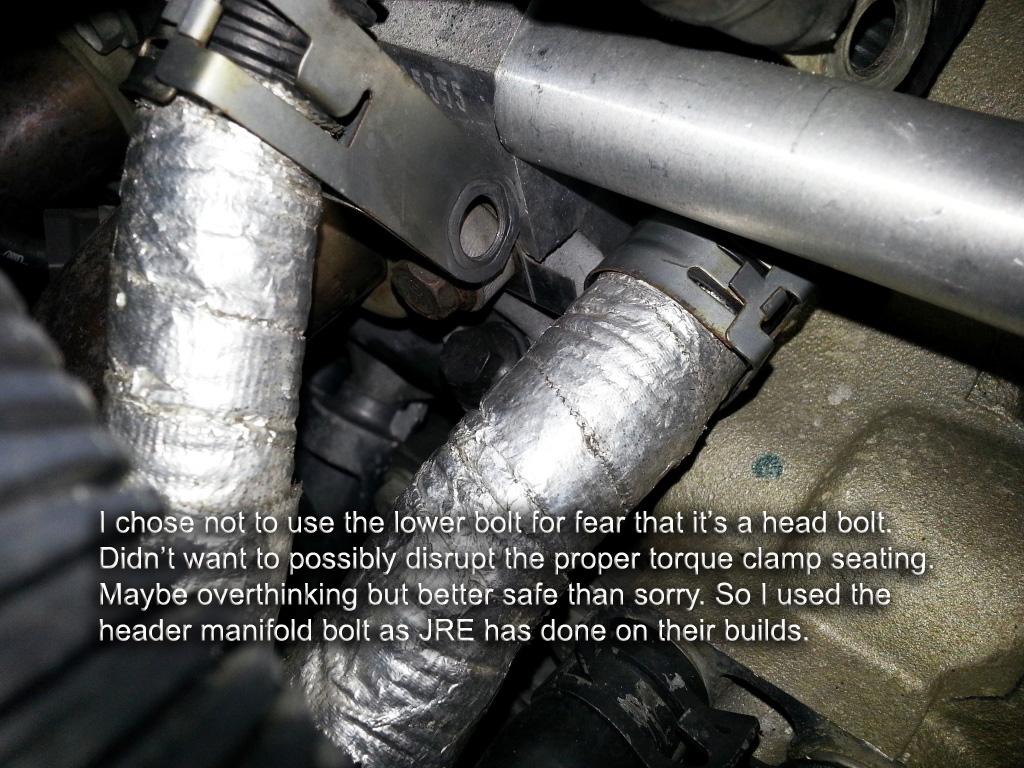

I searched and couldn't find an install how to so I am just doing this one real quick so it's out there. If there is one post it here so if people find this thread they can find the other as well.
Anyway........
When I first looked at it it looked kind of like it might not be very solid.
After installing it there was no doubt this thing is stout. WAY much more so than the stock tensioner. No more belt slippage here.
(In the video I say 'Adjust the tensioner' but what I mean is 'RELEASE the tensioner'.)
