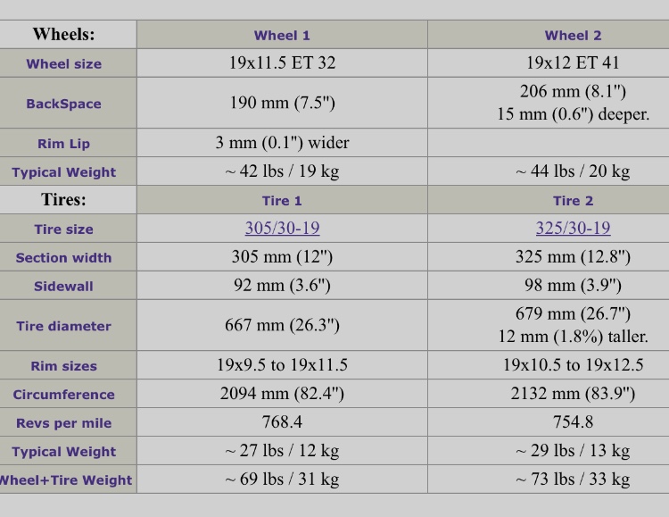

If I understand correctly, I need a spacer that is 15 mm wide. Or what do you mean?

Why are you saying 15mm?
Because the backspace of the 1LE wheel is 15 mm deeper.
47Ronin is offline   Reply With Quote
Old 10-19-2019, 08:51 AM   #10
j o n
j o n's Avatar
Drives: 2015 Z/28 #0058
Join Date: Apr 2018
Location: Pittsburgh, PA
Posts: 824

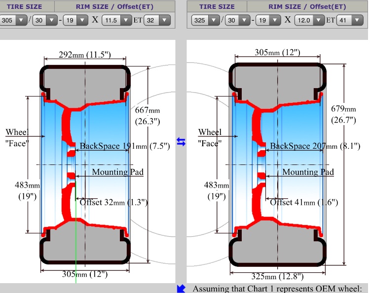

I see what you mean now... 207-191=16mm. Don't pay attention to that measurement though.
Just pay attention to offset
The z/28 owner above runs 325s without issue he says, with his +32.25 oem z/28 wheels. So with 325s on a +41, that's roughly 9mm closer to the inside of the wheel well. However as the pics show of the calculator, the tire is flush with the opening of the wheel well. So you don't want to go too far more outwards. I doubt you need a full 9mm, if at all. Start with 3-5mm. You'll be fine

47Ronin --
This page might make it a little easier to visualize --
https://www.1010tires.com/Tools/Whee...et-Calculator#
Biergut is offline   Reply With Quote

Jon, this is the result from the calculator from your page:
Inner Clearance: the same
Outer Position: the same
Does that mean that I do not need any spacers?
Would it fit easily?
