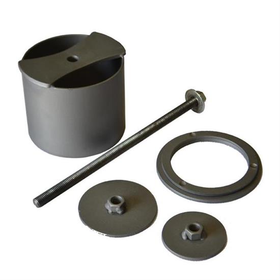

I have seen all of the DIY threads for removing the rear cradle bushings. All of them have been on the ground with jackstands and heat method. I will be doing mine from a 2 post lift. I also picked up the ridetech rear bushing removal kit for $20.00, so no heat method.
Any recommendations when doing it on a 2 post lift? Dont want the rear cradle hitting me in the head. Do i still need to disconnect the rear sway bar, the LCA's, and the struts to get the cradle to move enough to get the old ones out and the new ones put in?

Trying not to remove the entire cradle. I thought about getting a cheap under hoist jack like that for safety reasons.
I dont need much spacing to get the tool in as it looks like this. Just a small plate you have to put in there. But i also need enough space to put the new solid cradle bushing in.
You could probably get by with loosening the subframe and disconnecting the shocks.
