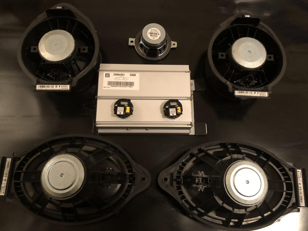

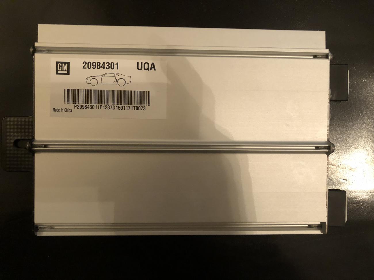

Boston Acoustic Speaker’s
I have a complete good working set of speakers for sale, in Florida. I only used them for 3 days. 2 tweets, center, mid door, rears, Amp, and 6x9 rears. $250
