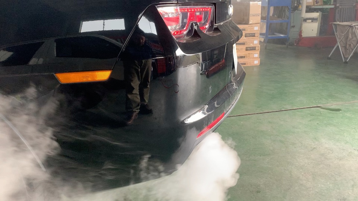

The white smoke from the 2013 camaro v6 exhaust is terrible. The error code is p0300, but I also replaced the o2 sensor once.
Is it possible for the stem seal to fail due to oil rising or oil falling? Oil change is managed. The oil is also clean.
The mileage is 50,000 miles.Name:  97CB3AA4-70DC-4DDC-8C75-2DDF7F7A3483_1_105_c.jpeg

White smoke as a rule indicates coolant in exhaust. Not good! Possible cracked heads or blown head gaskets. You can buy a test kit that tests for carbon monoxide in the coolant. Do not drive this vehicle. Seek help of a mechanic familiar with this vehicles. Good luck.

It could also be oil also. What's the smell? If it is somewhat sweet, it's the coolant.

You're burning coolant or oil in the engine. The P0300 is random misfire, which is being
caused by the leak into the chamber(s). As said, it can be oil, since synthetic burns
differently than conventional oil, which would be blue'ish. Synthetic oil burns gray'ish
to white'ish. There is a You-Tube video that shows a guy torching motor oil, and the
synthetics are much lighter in color when they burn.
Bad valve stem seals will cause oil to leak into the effected cylinders. When sitting,
that oil pools in the chambers, and burns on start-up, but usually goes away once
it has all burned off, and seeps in when running, and cakes on the back of the
valves.
IF you can sit idle, and that smoke comes out all the way to operating temperature
and keeps on going, then you have a serious leak. You can smell coolant, it smells
like it does in the container. Take a whiff of that smoke, and you will know if it is
coolant.

White smoke = coolant
Black Smoke = too much fuel
Blue smoke = oil
That most definitely looks like you're burning coolant. Not good
