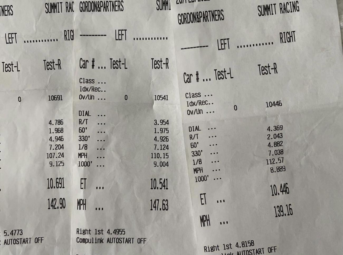

I got a spot for a private rental. This was my first time dig racing, and I admit it was harder than expected with the manual trans.
Out of the 6 passes I made, 3 were aborted due to spinning too bad recover. 3k, 3k and 4k leave.
The other 3 I left at idle, 2k, and 2500. All of these resulted in 1.9/2.0 60’s.
Despite the horrid 60’ times it still went a best of 10.4@139. Highest trap was 147mph.
28x10 MT stiff walled slick and bias ply skinnies.
Guys at the track said if I get the 60’ to a 1.6 it would go mid 9s. But until them it looks like I have a 10.50 street car.
It was an absolute blast, and my buddy went 8.80@159 in his big single 388 th400 5th gen!

I think on that run, I actually lifted before the line. You can hear it in the video. I thought I botched it at the start, so I was just running it out for data. Probably explains the lower trap speed.

2nd gear burnout. A little better slipping the clutch, but still a 1.97. 10.5 @147. You can hear i did not lift this time. Of course i let out on what turned out to be my best pass.. total newb.

Don't beat yourself up. A rookie drag racer attempting to pilot a 1200 HP, 10 sec car at nearly 150 mph is a recipe for frustration (if not disaster). You can reasonably practice your launches on the street in a secluded area. Work on discipline and fundamentals. You need repetition, seat time and more seat time. Next time you're at the track don't try to be the fastest guy out there. Focus on being consistent and steadily improve. Bill Jenkins and Ronnie Sox didn't become Pro Stock heroes overnight.

Disaster is right. First pass i was missing 2 psi from the drivers rear, and 4 psi from the passenger front. The wall tried to suck me in at 147. After evening the tire pressures it went straight as an arrow. Ill never make a pass again without checking first. Doodoo touched underwear.

The magic you need will come from controlling clutch engagement. Lots of trial and error in trying to perfect a foot-controlled launch, lots of wear/tear on the drivetrain as well. You can avoid that frustration and skip to the front by adding a clutch hit controller.

More RPM, more slip, and less throttle pedal will get that to roll those first few feet under better control and keep the tire hooked up. My quick read on watching the videos is your initial bite on the release is way too hard, shocks the tires, and then you're playing recovery from there with the throttle and it's actually lazy for a tick and then comes right back on. Using the e-brake and preloading will definitely help you be right on that engagement point with the clutch, rather than it surprising you as you make your release. We've talked, it's a lot of car to hook up, and some seat time will help a bunch.
For other guys checking this out that are interested in the "preload" method for stick cars, I have a long boring youtube video about it. It has some good info on how to use that technique to gain consistency and most importantly reduce breaking - those shock loads on the initial clutch release (and any accompanying wheel hop) is what kills driveline parts.
