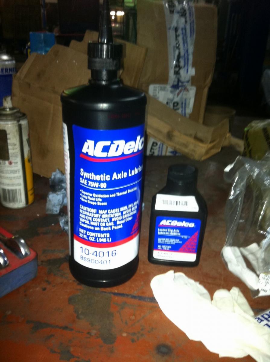

1 liter of 75w-90GM differential oil (89021677or 89021678)
1 bottle of LSD additive but you will need only 75ml of it (1052358 or 992694)

7) don’t forget to add friction additive to the differential oil (75ml of additive on 1 liter of oil)
