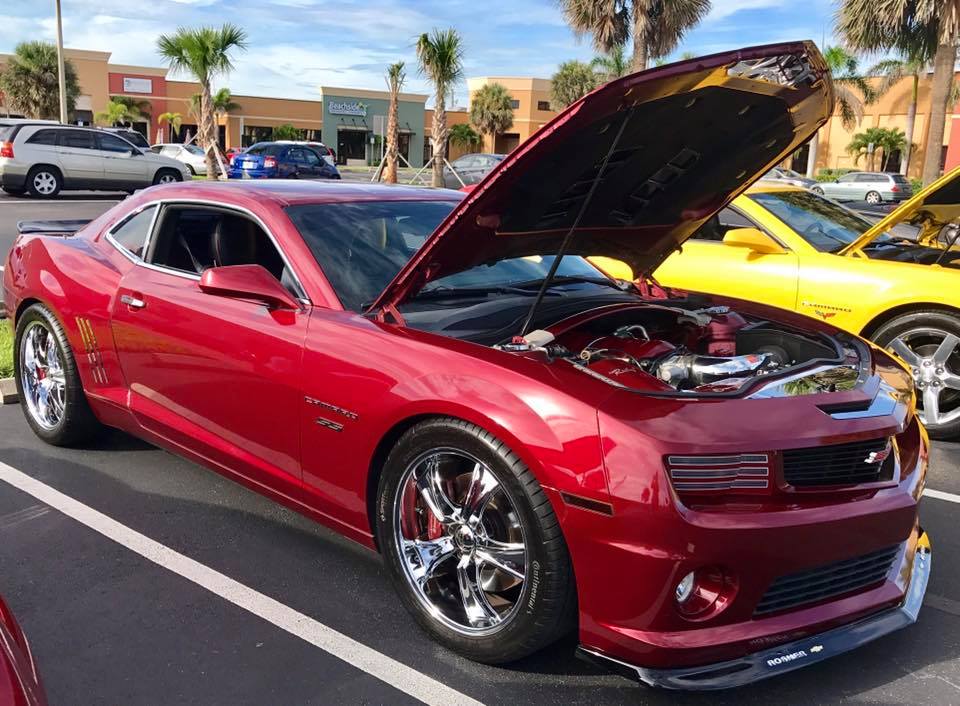

Back when I had 10 inch wide rears I ran 315/35's for many years with no issues, and 275's on the front on 9 inch wheels. Here is a pic.
