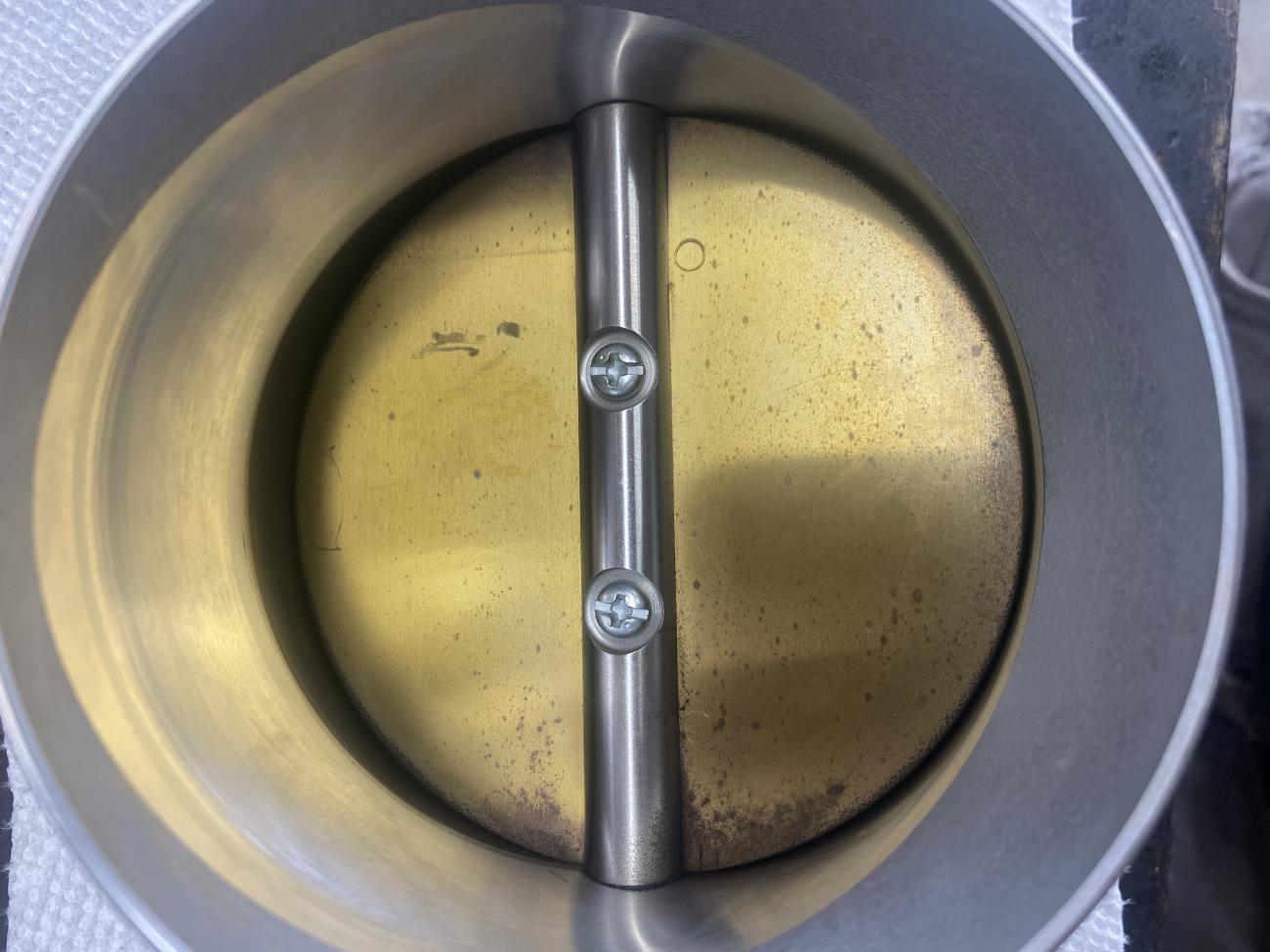

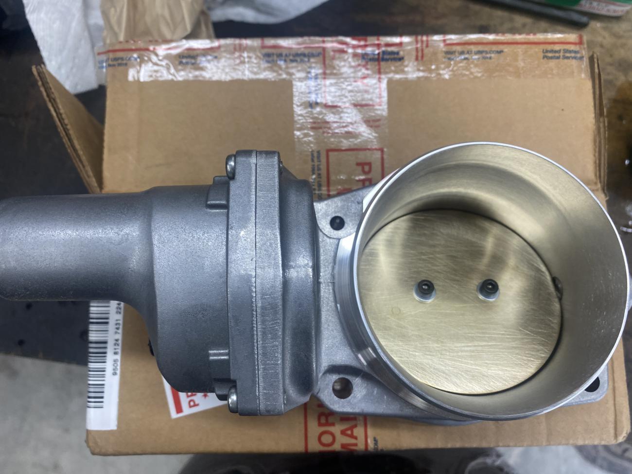

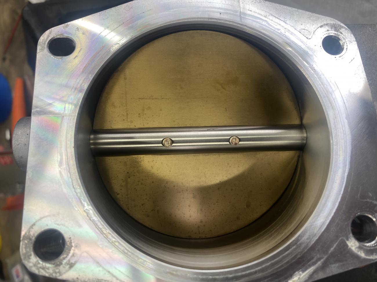

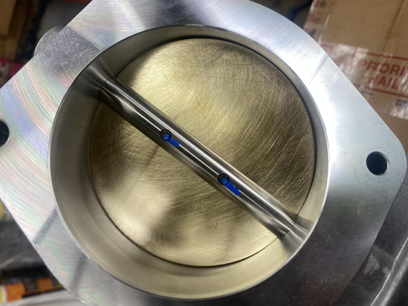

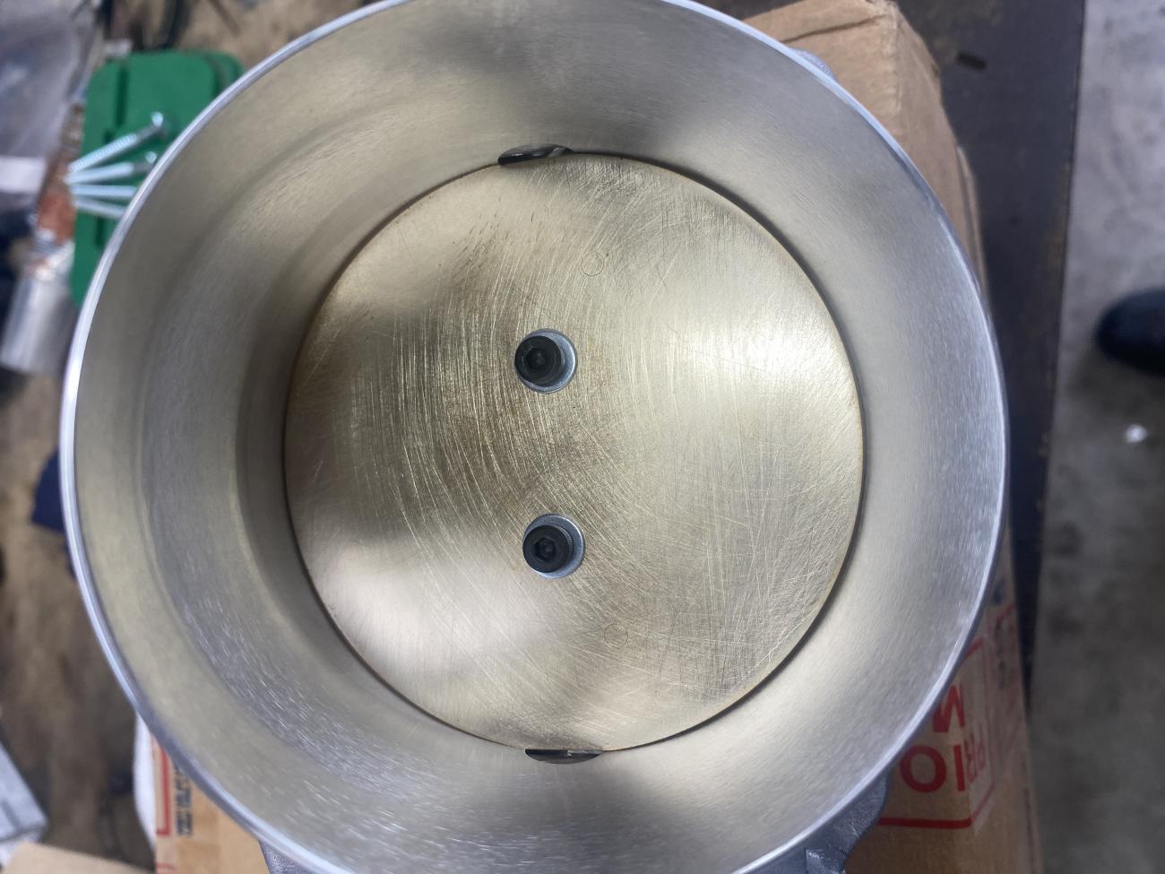

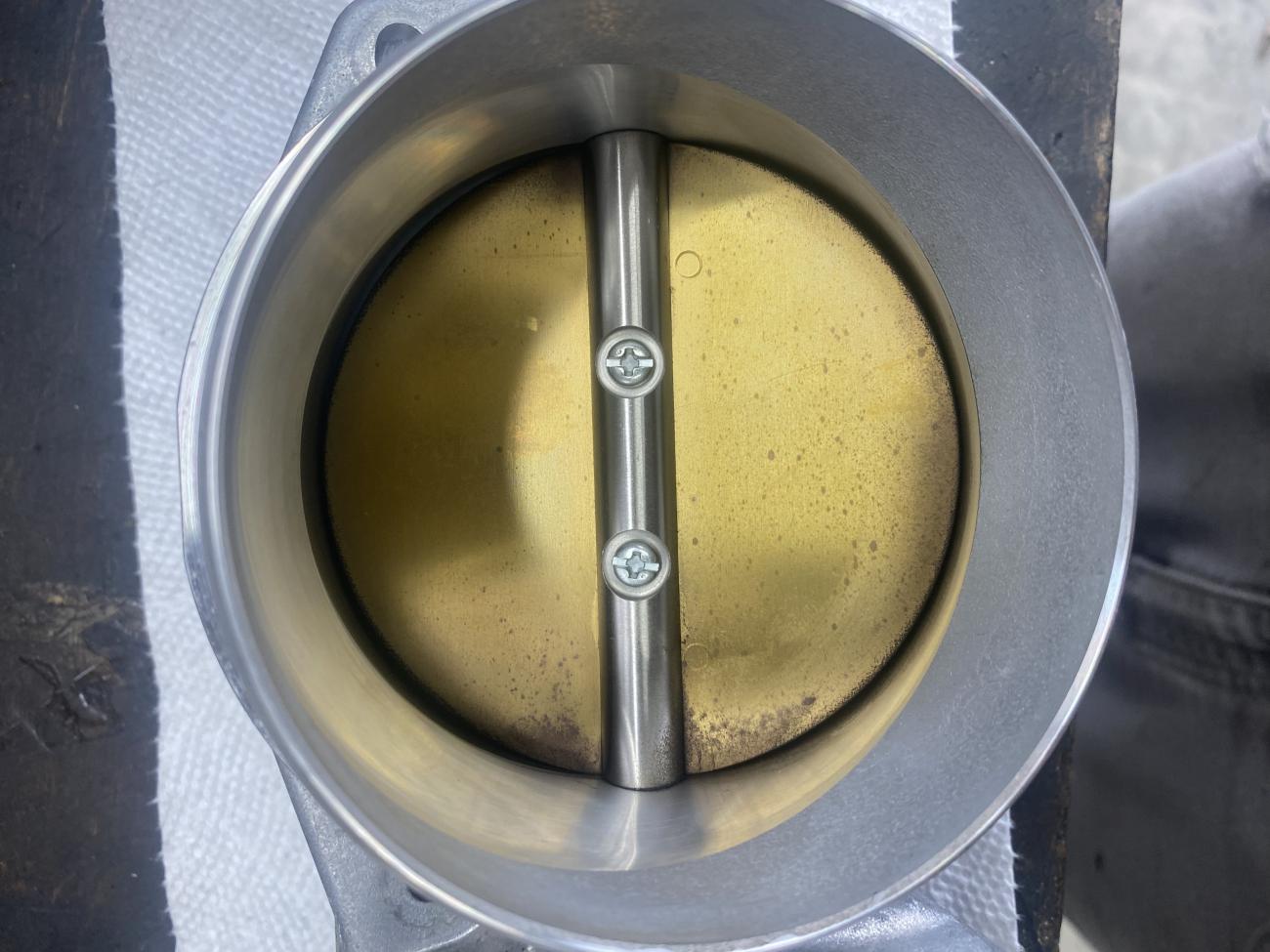

Posts: 1,901
Photos of ported and stock attached.
