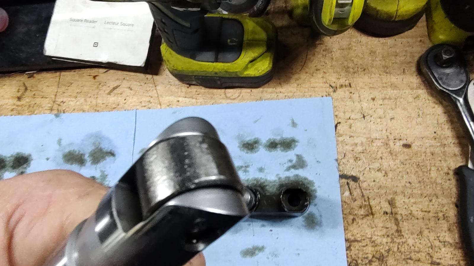

Caught it just in time...was a bad lifter..grind marks on the roller...and the roller itself is loose...so ordered a set of Delphi ls7 lifters...cam motion lifter trays..BTR stg 3 supercharger cam...636/636 lift ant 226 duration ..heres some pics of the lifter...will post pisc of damage cam soon

Nice work. This is the pinnacle of knowing your car and responding appropriately. Great catch and she lives for another day.

Awesome find!! This all goes to "knowing" your car and what's going on, AND not pushing it past the point "of no return", causing more damage. Good job sir!!

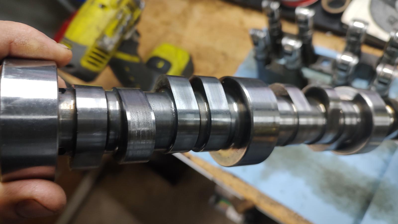

Here's some pics of the cam..its a LPE GT9..its not so bad.. probably could be reusable with a good polish...but will still go with the BTR stg 3

Yeah, I wouldn't use that one anymore. You could try a polish on the lobe, but I think in doing that as far as it has been damaged, you would risk the chance of taking off more material, just enough to get the lobe in that "soft area" of the metal that hasn't been heat treated to withstand the friction and load, and then you have another problem. Put the new one in and don't look back. Just my .02 dealing with engine internals in the past.
yep..i will keep it as a artifact lol !!!!

Awesome. Yeah I have seen what can happen when you re-use internals that people second guessed on, wasn't pretty, and since you have it all apart, might as just do like we always say, "do it right" once, and be done with it and enjoy the "piece of mind" it's all new. Good luck with your build!!
