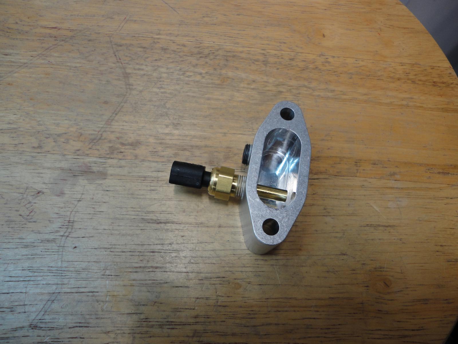

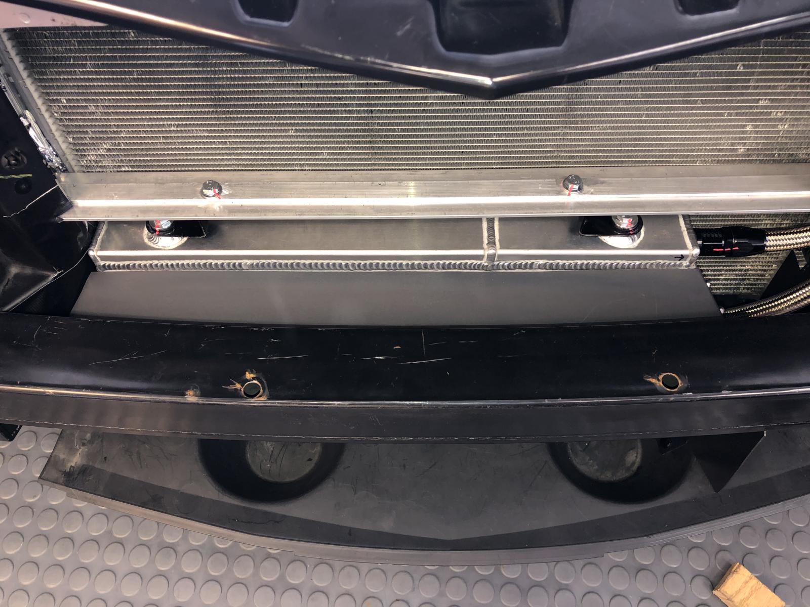

Do you have a standalone oil temp probe and gauge? If you do not and are using the OE temp indication, it is not a true #. There's posts here on the forums about the OE indication being artificially generated. It will always max out at 266*F but in reality it could be much higher. When I switched to the Mishi I ran an Autometer oil temp gauge that took the temp at a bypass block of the LS3's oil cooler line mounting point. My gauge showed 294* at my next track day.
It is possible that the Mishi cooler mounting area was not the best. It also is nowhere near the size or efficiency of the IR cooler. I maximized the mounting location of the IR and after that install I had 217* max. That summer I ran a 45 minute full tilt session in the heat and it was perfect.

No I don't have a dedicated oil temp gauge I'm still using the factory stuff. But I thought I read that the factory gauge for 2012 - 2015 was a real gauge because it actually has 3 wires going to the sensor. I was wondering if the 2010 and 2011 have 2 wires or 3 going to the sensor? But your also measuring the oil temp before the cooler correct? Myself, I think I would like to know what the temp is after it has been cooled by the cooler going back to the engine.

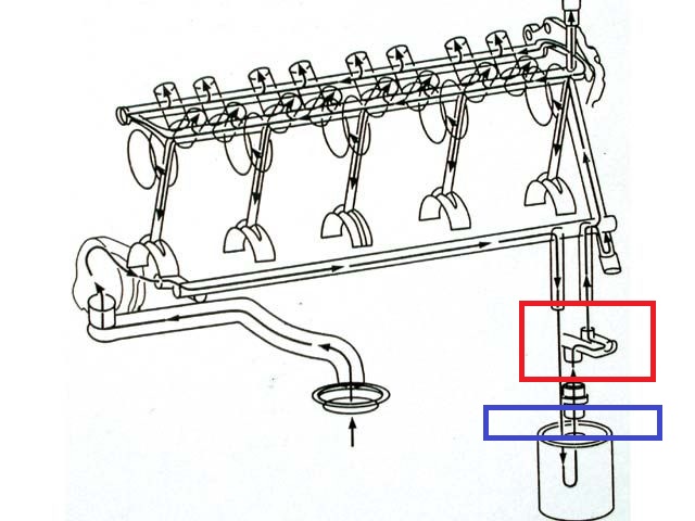

I believe how many wires going to the sensor is irrelevant, because the PCM's output to the DIC is not a true reading. A factory 4 gauge pack may show otherwise, but either way, with what I found, the Mishi alone wasn't enough. And that was with the Autometer probe at the area shown below in the red square using the above bypass adapter I showed in my previous post.
No, I am not measuring the oil before the cooler. As you can see oil flowing at the bypass adapter is on its way to the bearings. And in my case by using an oil filter sandwich adapter (at the blue square) to send oil to and return from the oil cooler the oil is cooled and filtered at the bypass adapter (red square) ready to rock n roll.
Attachment 1118063
So you have a bypass adapter at the oil filter housing? Mine is on the side of the block before the oil filter housing. By your picture I can't tell where it's at. And yeah I would like to know the same thing as the op but I think you already said your using a sandwich adapter. From what I saw it looks like the mishimoto oil cooler lines are the same as the IR cooler -10.

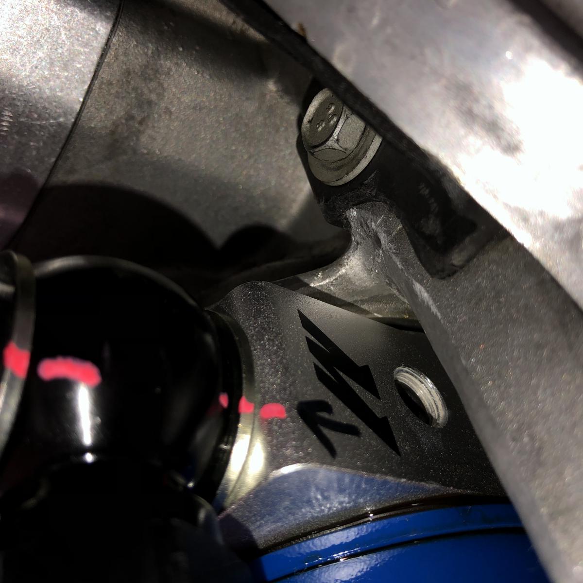

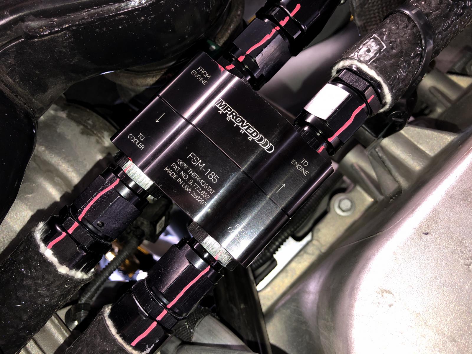

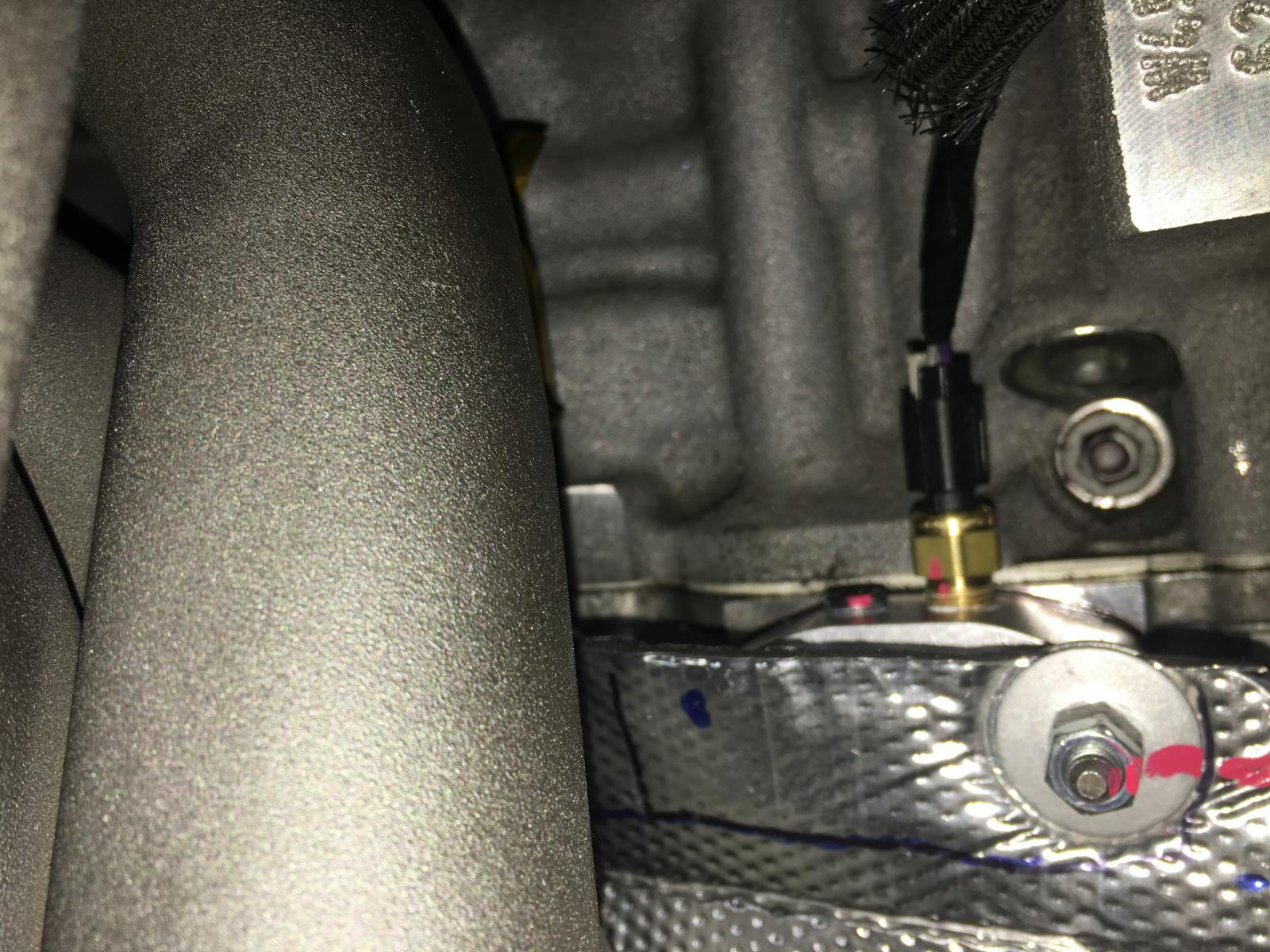

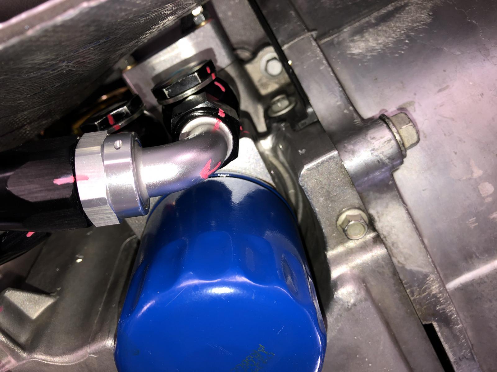

I used the IR cooler but a Mishi oil filter sandwich adapter and an IR thermostat. I had AFE PFadt headers. That Earl's adapter may work with your headers but my AFE headers, there was not enough room. And the IR Gen5 kit uses a similar adapter which also would not have had enough clearance. That's why I went with the Mishi sandwich adapter.
No, the bypass adapter is at the bypass pad above the oil filter pad. That would be the area in the red square in the above post. I had a Mishi non thermostatic oil filter (silver) sandwich adapter that fed the oil cooler. I had an IR thermostat block in line with the -10 lines. You want no smaller than -10 lines. The IR thermostat shows 185* but I later installed a 205* valve because initially the oil was too cold. I have a bunch more pics on my build thread:
https://www.camaro5.com/forums/showthread.php?t=395103

As for your actual oil temp sensor, where did you rig that up? I see you put the sensor on the block off plate, but what about the gauge? A pillar pod?
That is on my list of things to do.
2013 1SS/1LE

It looks like I will need to remove an E-clip at the cooler to get the original off and reuse it to secure the new one. But it does not look fun.
