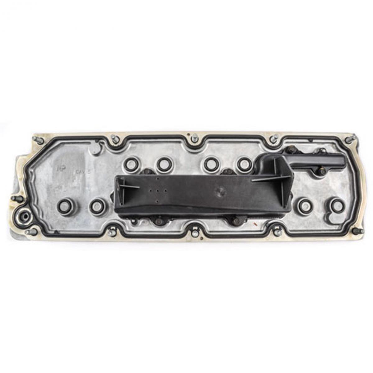

Yep, if you look up the parts number, that's the LS3 engine valley cover, which has the PCV system underneath it, and the external port at the corner of the top. There's the LS2 engine valley cover (P/N 12570471), which is more or less almost exactly identical, except the external PCV port has the hose barb towards the end of port, rather than in the middle of the port (LS3 valley cover).

Here's the bottom of the LS2/LS3 (LS Gen IV) engine valley cover. On the sides of the black plastic PCV baffle thing, there's two open slots, but I'd have to take close-up photos, to maybe show you and have others maybe see what's going on with it. If you see the perforated holes on the other end, I have no idea what those do; but I assume some oil may be picked up through it?
J35Y2 is offline   Reply With Quote
