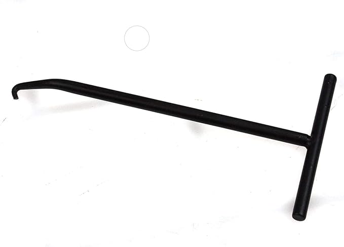

I use T-Handle hook tools for spring removal and install like this one. They have short and long handles, Can be straight or on an angle.
Nice! I hadn't seen these before, I might see if I can find one short enough to use in there, it's a tight squeeze but I might give this a shot.
