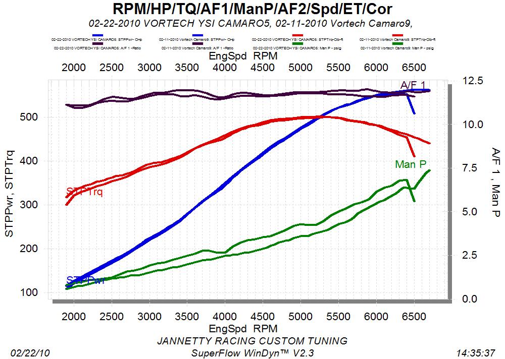

First 2010 Camaro on the Dyno With Vortech YSI Supercharger
First YSI on a 2010 Camaro.
I am happy to report that with 1 lb LESS boost we made 10 More HP and same torque.
Now it is time to turn up the wick a bit.
The Lower Green Line is the Boost for the YSI
And the Fuel Pressure is a wee bit Better.
562 RWHP at 6550 RPM and 500 RWTQ at 5350 RPM,

Now I am going to steal the 3.33 pulley off my 1970 Chevelle Wagon and see what we can do.

is this a stock car auto or 6sp?
Bone Stock LS3 with ARH headers and cats.

Vortech YSI with 3.33 Pulley
OMG, 610 RWHP 545 RWTQ 9 PSI Boost 15 degrees timing 12.0 A/F Fuel System Is Tapped Out fuel pressure drops to 48 psi.

Old 02-22-2010, 03:38 PM   #6
mr_desmo
Banned
Drives: beated up old mini austin
Location: north pole
Posts: 440
This is incredible results for such low boost isnt it? At 5200 rpm its barely pushing 3.5 pounds of boost and its pumping 500whp???LOW engine stress hi whp!

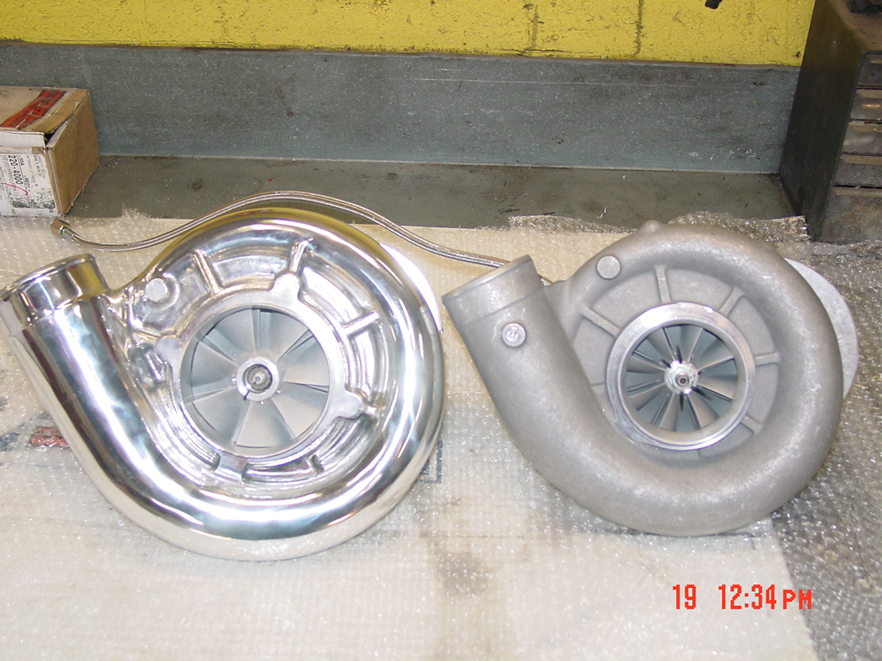

Ted, Any pics of the installed unit??
www.jannettyracing.com
