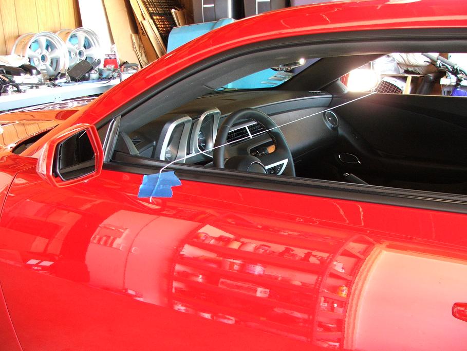

So I really love this car and maybe it's making me extra picky. I've noticed that the steering wheel alignment is a little off - the distance from my left shoulder is farther than my right. The wheel is not perpendicular to the centerline of the car. I thought it might just be in my head, perhaps the alignment of the gauges. An experiment was in order. I strung twine from both sides of the car, with both ends the exact same distance from the weatherstrip at the far front of the door (approx 7-1/14"). Just as I thought, the left side has a 1/2" gap where the right side is flush with the string.
Maybe it's supposed to be this way. The engineers may have been thinking of giving more room to the left arm as many may drive single-hand with it. Has anyone here noticed the same thing, and is this normal? Never noticed it with other vehicles...

haha i was about to say maybe your arm is longer than the other lol but then i saw the pic kinda odd
do you feel any wobble when turning lock to lock

Nope, there's no wobble lock to lock. The wheel is perpendicular to the column. The column itself is shifted a little to the left it appears. Up/down & in/out telescoping work fine. There's no left/right movement either with the wheel locked or when adjusting. It's as though the other end of the steering column is hooked up in the wrong spot (too far to the right). Anyone else notice it?

Lol, nope, not a machinist but I am an engineer. If it was a small amount I probably wouldn't have noticed it but the right hand side of the wheel is 1/2" closer to me than the left side. I'll have the dealer check it out and see if there's an adjustment on the other end of the assembly when I bring it in.

Yes it is - the wheel is perpendicular to the column. The column is mis-aligned to the centerline of the car.
