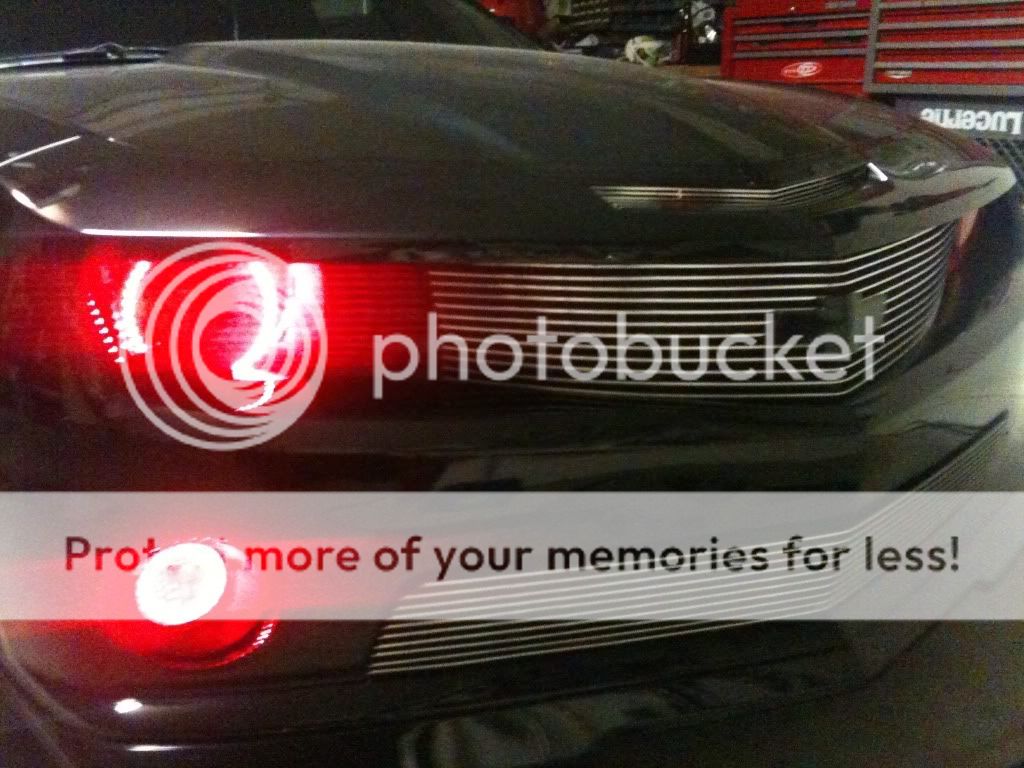

I looked at a few pics of halos on non-RS cars and decided to hotglue the halo to the black headlight frame. I tried silicone at first but it wouldnt dry fast enough so hotglue was the trick. Also, I didn't have any epoxy. Initially I didn't think just lining up and gluing in place would work because the black housing and the reflector back up to each other and have no gap between them. This would cause the clear lens to not seat completely in the back half of the head light assembly because of the extra width of the LED. And I was right. The two pieces will not mate up as perfectly as oroginal. However, it is not nearly as bad as I thought. I didn't do it but I was wondering after the fact if there is any merit in using a dremel and notching the black housing so that the led ring would sit flush and not be mashed between two pieces of plastic. I didn't find any links on the site that gave any details pertaining to this and unfortunately AAC's directions for this left much to be desired. I am pleased with the look of the lights in the end, but while I was doing this it sure felt like I was trying to make a generic universal product fit in a specific application.
Bottom line: centered halos, hotglued in place, silicon sealed two halves of headlight assembly, clamped, added sealant to minor gap, waited 24 hours, reassembled Camaro....piece of cake.
BTW, my camaro looks BADA** with those new red halos!!!
I will post some pics later.
