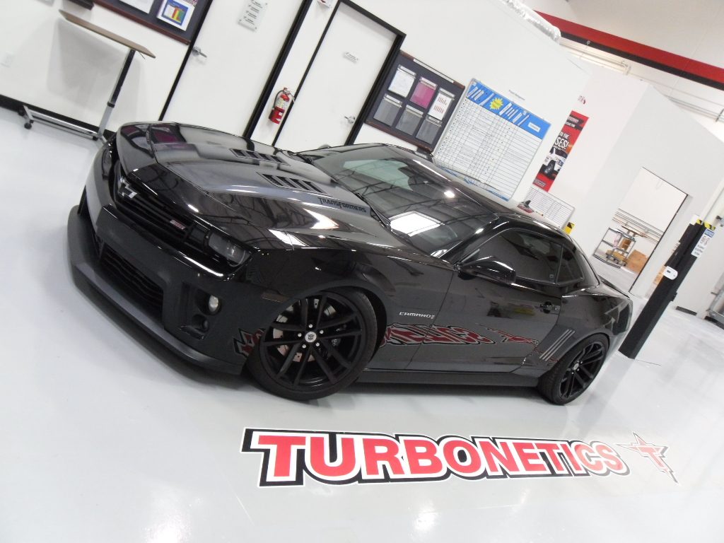

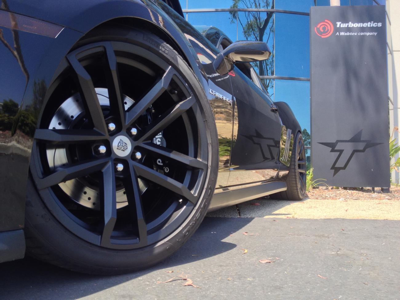

I have BCs about a 2" drop.
1. wheel offset can determine how much you can lower the car.
2. Camber Alignment (negative camber will help you tuck the tire, dont go crazy on the negative camber do.. -0.8 max or youll have tire wear problems.)
3. width if tire and wheel.
Im not sure on stock wheels..
but My setup is Zl1 replicas per GM specs
11" wide wheel rear with 295/35/20 michelins -----10" wide wheel front with 275/40/20
clearance is tight as a virgin in my car, but no rubbing
CamaroSS sleeper is offline   Reply With Quote

Nice ride!! Any more pics of it? Are the BC's maxed out with that drop or do you still have space between the collars to go lower if you wanted?
pbclax1 is offline   Reply With Quote
Old 04-29-2015, 11:59 PM   #10
CamaroSS sleeper
Drives: Sleeper_NOT
Join Date: Feb 2014
Location: Ventura
Posts: 184
Thanks!!
I still had about 1/2 drop between the perches.
But i actually had to lift it about 1/4 all around because it was simply too low to be a DD.
Anyways...
Here is two other pics while it was still nice and low.
