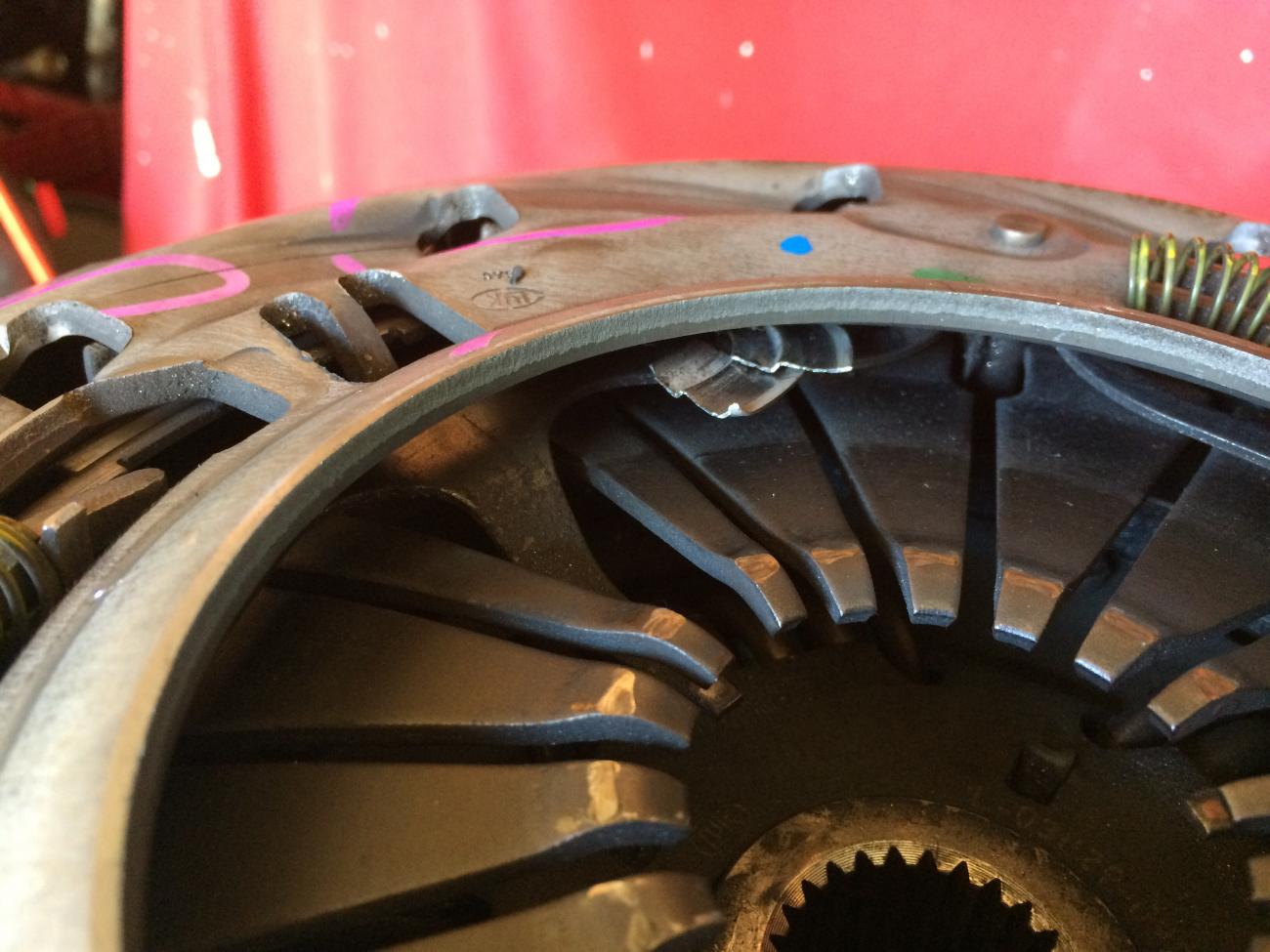

Been busy with work but finally finished replacing the clutch. The old throw out bearing completely fell apart and sent pieces of itself into the clutch, wedging itself into the diaphragm. The stock clutch looks brand new but I still replaced it for a lighter twin disc.
Pic of the bearing support and what's left of the throw out bearing.

Posts: 1,567
Pieces of bearing wedged into clutch diaphragm

Posts: 3,056
So will that billet replacement part take care of this issue for you? Have fun with your new clutch! At least you know exactly what was wrong...

It should take care of the issue. It wont melt and leave the bearing unsupported. The new clutch makes the car feel a little lighter so I'm happy so far.
