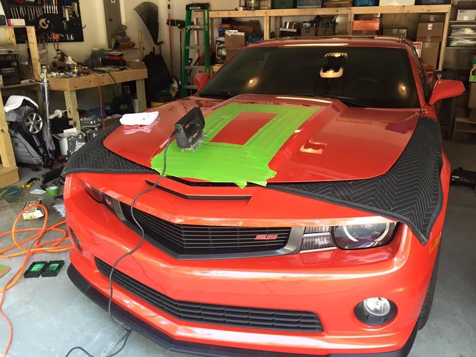

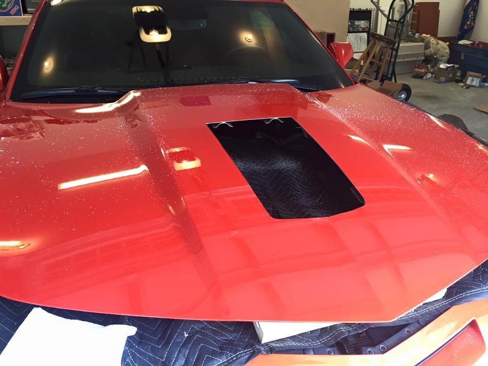

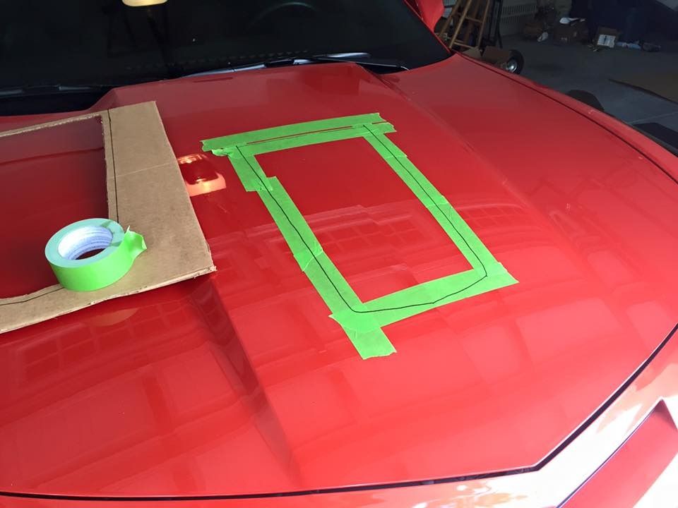

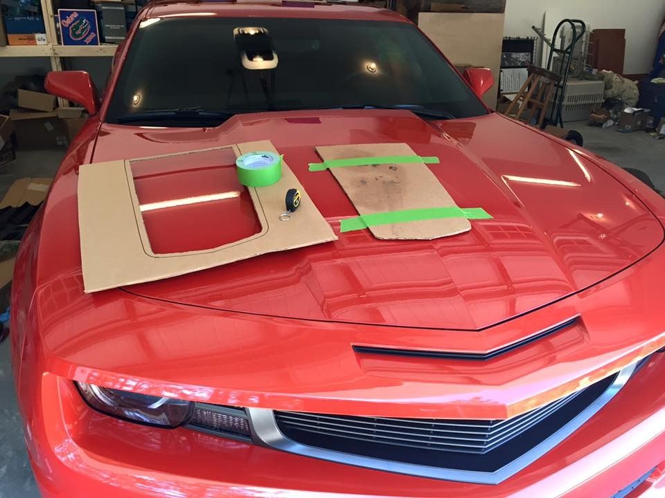

Here are the pics from my install. I tried using a cutting wheel but my air compressor didn't have enough juice, so I ended up using my jigsaw with a new metal blade. Cut right thru with no problems. Install came out great. I didn't use any of the aluminum strips and don't have any problems with the way it's sitting in the hole.

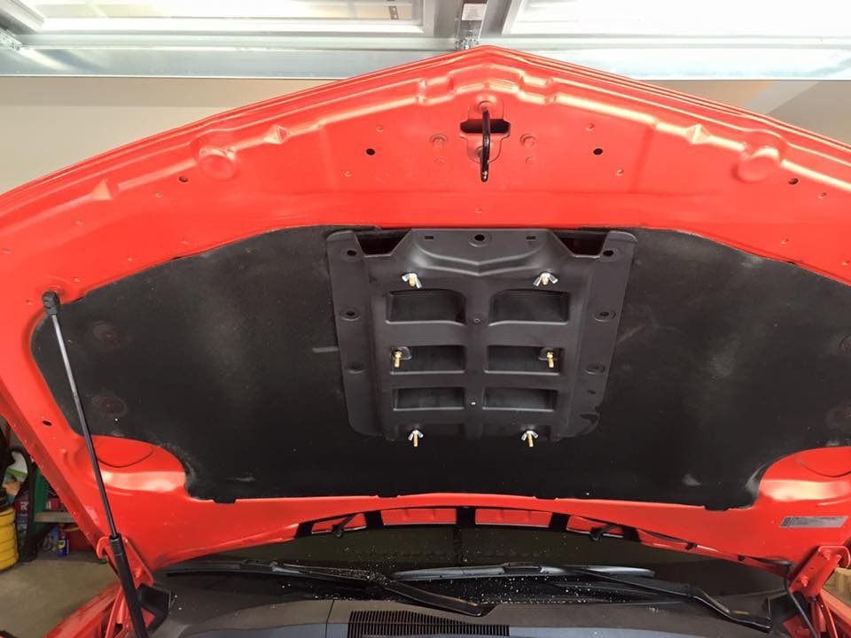

Slightly different installation
I just finished installing my heat extractor. Have a couple of pictures to share. As you can see the mounting method is a little more like that on the 14-15 models in that I made tabs rather than spanning the extractor, I was worried that the little air flow I would have with the rain shield installed the hardware would block more of it. I also warpped the extractor in Matt black vinal. Still need to wrap the hood.
