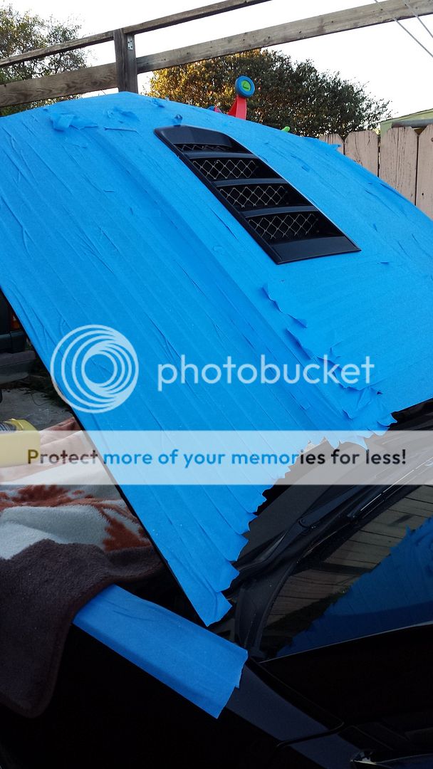

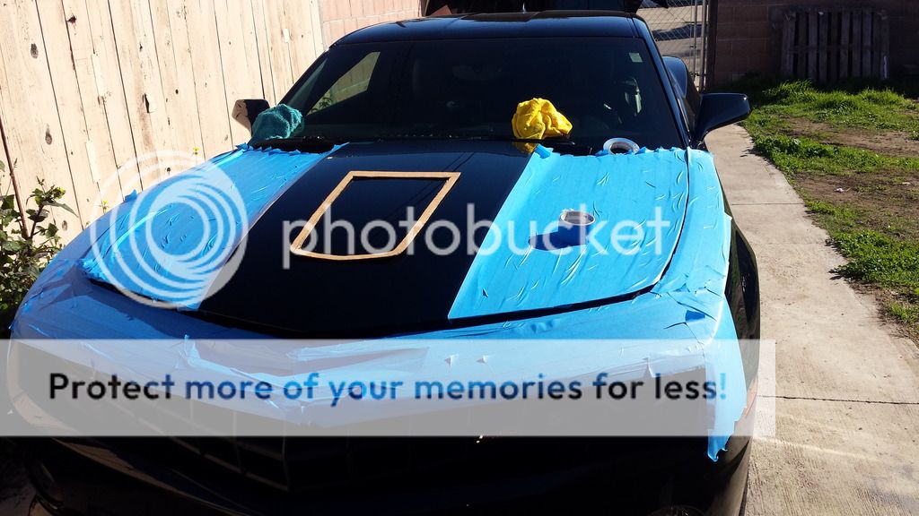

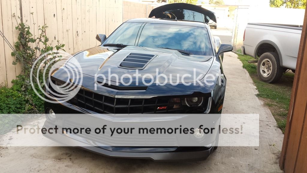

I got mine done..turn out great

That looks great, nice job! One day I may have the courage to do this lol
