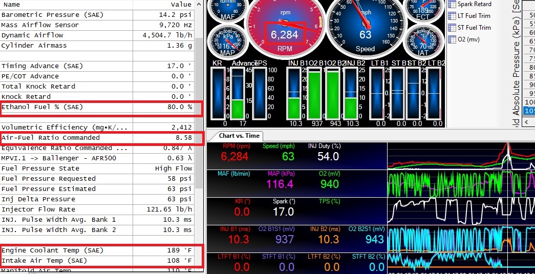

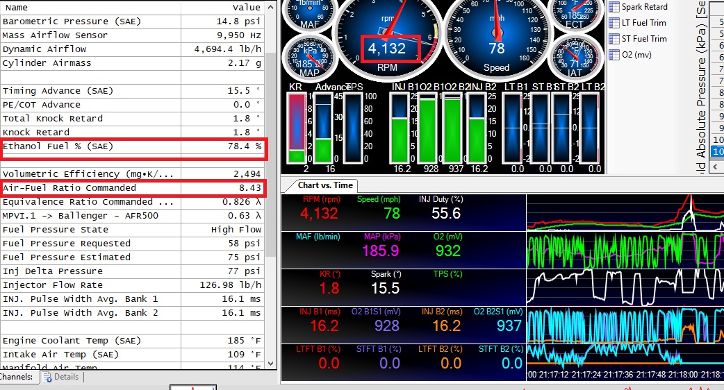

So, this is not consistent when it goes to 0% Ethanol. Here is a run, where its perfect:
Now, few minutes later, did it again -- started out great, then literally a split second later, went right to 0% Ethanol:
Looking good here:
Now, 2 rpm more, 0% Ethanol:
So, it acts like an electrical issue from what I'm seeing here -- its just sudden -- from ~80% to 0 in just 2 rpm -- and this happens for the next several tests.
Working the electrical/heat angle (did check the fittings -- no leaks anywhere just to be certain).
-Don
747 RWHP 794 RWTQ
