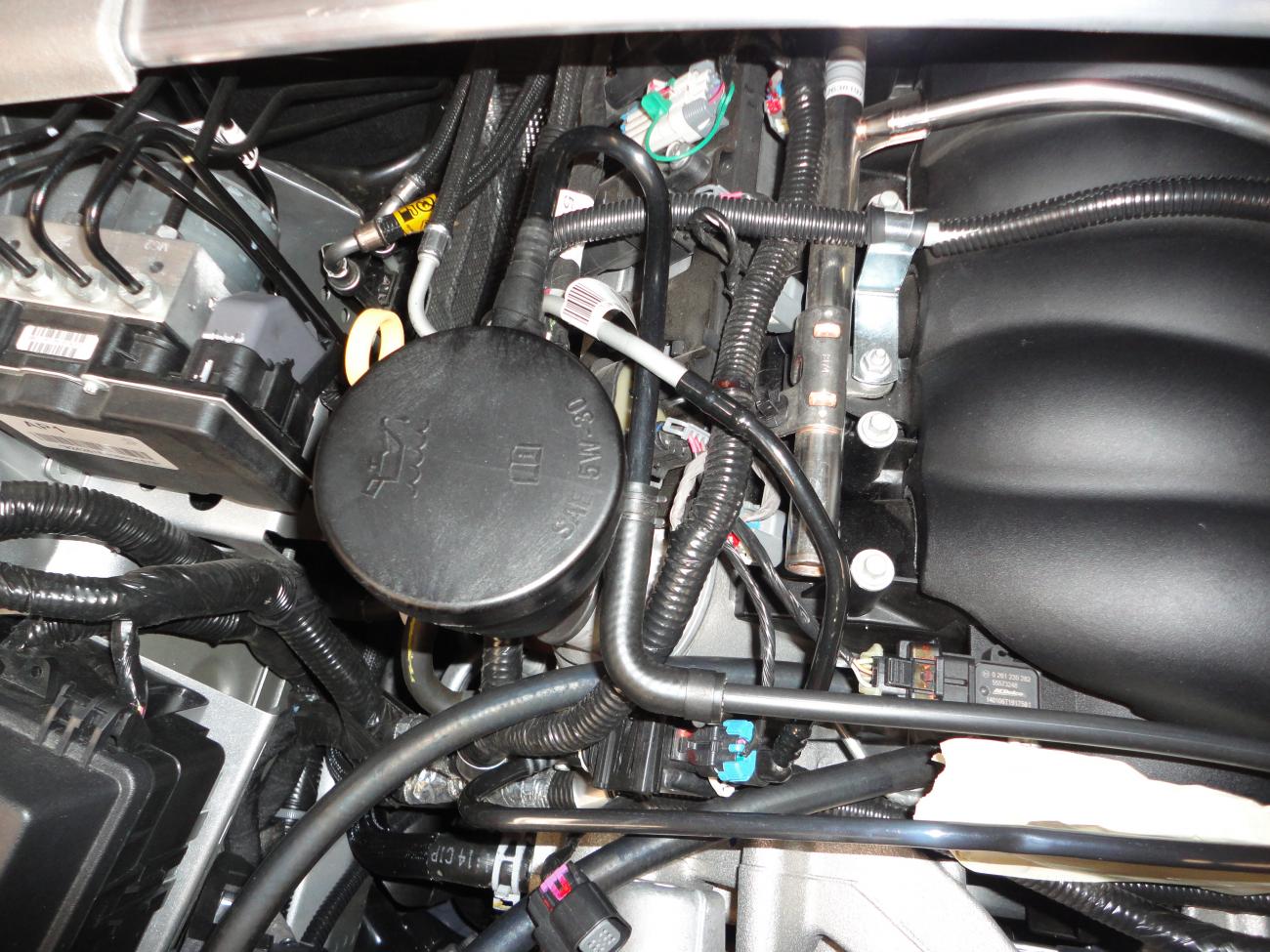

Originally Posted by cdb95z28 View Post
Attachment 679696
One reason I went a different route is the 90* fitting that the Z/28 uses. It just looks better than putting the rubber hose from the kit on the CAI.
Attachment 679699
I used Dorman HELP! part # 46002 and Dorman 800-059 from AutoZone.
http://www.autozone.com/fuel-deliver...8_116463_4169/
This one will snap right in to the Z/28 CAI
http://www.autozone.com/1/products/3...elp-46002.html
I cut this one in half.
Attachment 679697
Attachment 679698
I also used a couple of black GM hose clamps at the rubber hose. I cut the plastic tubing coming out of the PVC separator installed the 90* (46002) to it and the 800-059. I used a hair dryer to soften the 800-059 to have a slight radius to meet the Z/28 CAI. Becareful not to rush bending the hard plastic tubing, you can kink it! Nice even heat and a gradual bend.
Looks like it was engineered to the LS3
Also, regarding the MAF on this CAI, GM calibrates MAF sensors to the intake system, not necessarily to the engine. When you bolt on other aftermarket CAI's, your stock MAF will not be calibrated correctly, unless you get a tune and your tuner calibrates it. I checked the MAF sensor on my OE air intake, the Chevrolet Performance Z/28 CAI and the OE Z/28 CAI and they are all the same. Part # 15865791. As for the calibration, I am able to see this via HP Tuners and the MAF Calibration Table is different between my 1LE and a 2014 Z/28.
