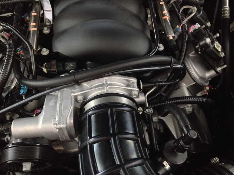

I just put the Z28 CAI intake on this past weekend. I ended up buying the stock Z28 PCV line as well and then basically just using the 90 degree end. I used a razor blade to slice through the plastic line and left about 1/2 inch or so of line attached to the fitting. I then slid the rubber hose over the fitting and routed the rubber hose so that it neatly tucks up inside of the cover. I used a couple of zip ties to hold the line in place. Worked great.

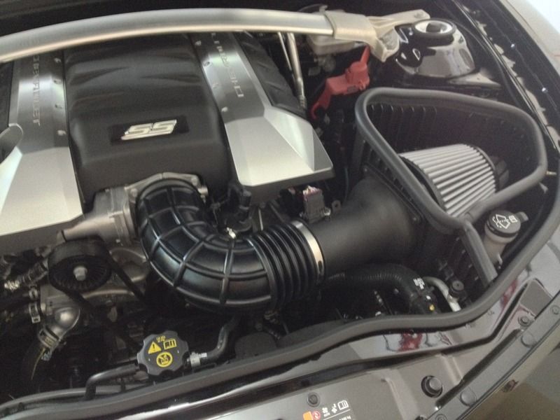

Ron71, in inspired me.
I decided to take another look at running the clean side PVC line underneath. I think I have it where I want it now.
BEFORE:
And AFTER:
P.S. Perhaps it can be done with some additional manipulation, but my MAF sensor wiring is too short to allow it to be tightened up against that tab. So, I probably won't mess with it.
