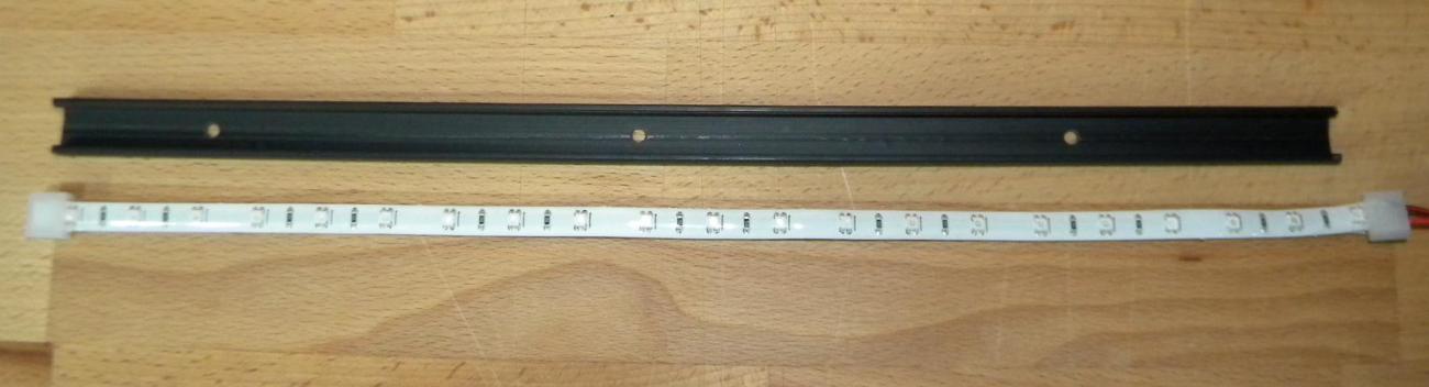

Originally Posted by Avalnch View Post
As luck would have it, I was doing some fix'er up jobs around the house and one of them was to install new floor transition mouldings on some of the room door thresholds. I went to the Home Depot and picked up this plastic channel that is used to hold down the "T" shaped piece of floor moulding.
After the job was done, I had some extra lengths of the plastic channel and I thought, "This would be perfect for holding the LED foot well light strips" (that I just received from AAC). Haven't installed the strips yet, but have a look at these pics. The strip fits perfectly within the channel and it will be easy to zap strap them on to the underside of the dash where there are convenient holes. The passenger side is especially helpful cause there isn't a good flat surface for the light strips to be glued to. The footwell strips have 3M double sided sticky on it.
Attachment 165222
Attachment 165223
Attachment 165224
These plastic channels come in 36" lengths.
This is a fantastic tip for mounting led light strips for the foothills. I could not find a good location for the strips then I saw this post. I had some of this laying around from a flooring install and the light strip fit like it was made for this. I put some double sided tape on the bottom of the channel and it was super easy to mount especially on the passenger side where it's tough to find a smooth surface to stick the light strip. The extra mounting surface on the channel made sticking it up a breeze. Thanks for the tip and to the OP for the wiring pics they made the job easy.
zandron263 is offline   Reply With Quote
