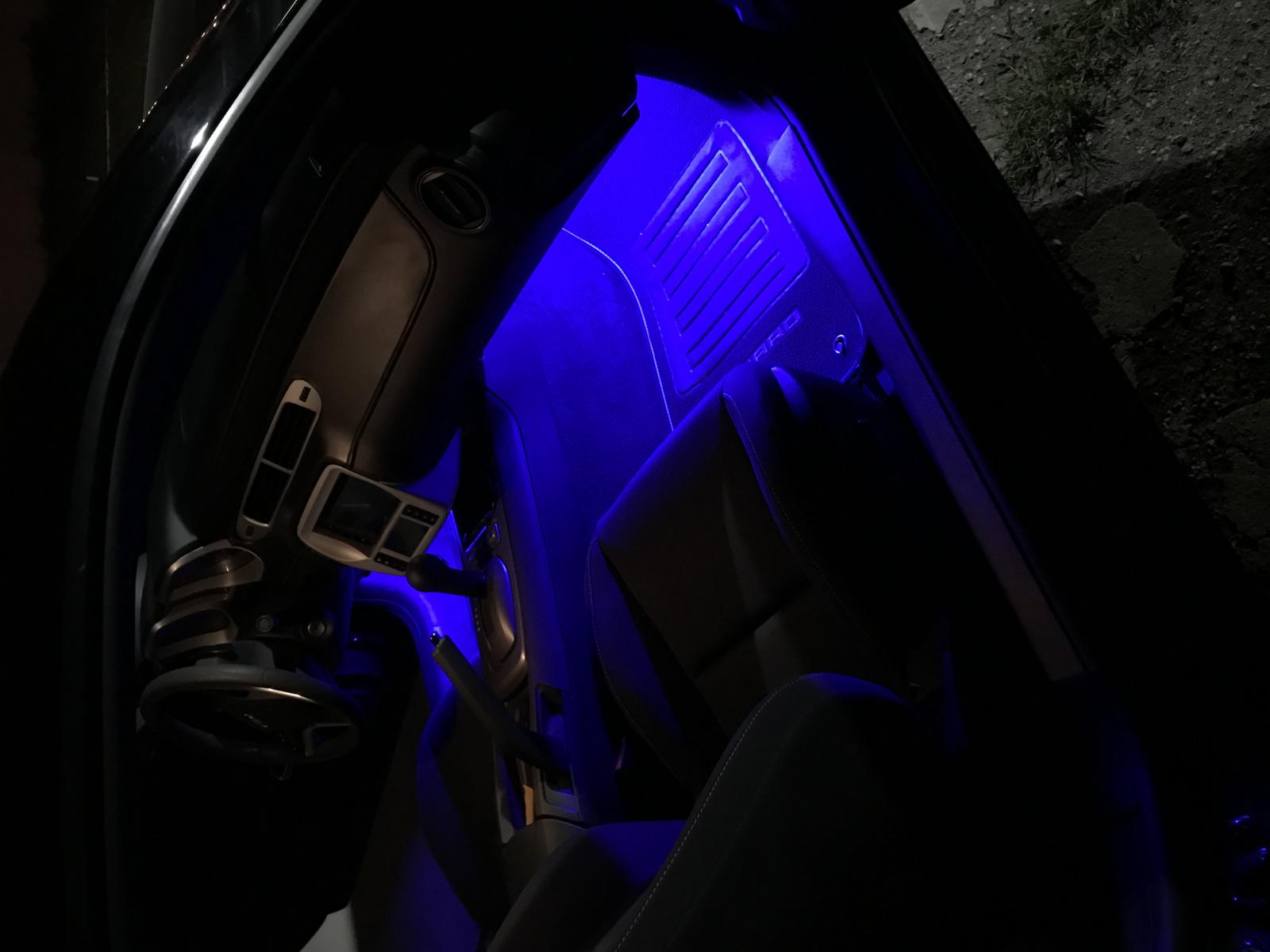

Did mine by tapping into the dome lighting as said in OP. At first it wasn't working but it was cause I used a t-tap made for 16-18gauge(blue) and it was too big, I then used a red one 18-22 gauge (I think?) and they came on immediately. So stoked! Hardest part was reaching in to tap into the gray wire.
Edit: not sure why the pics came out sideways, uploaded from iPhone. Sorry :/
